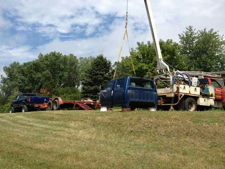

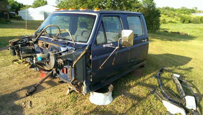

Just picked up the new cab this morning! Rust free! Came with doors and all interior. Xlt with blue. That and new front clip only cost me $400
swamp_ratt
1,506
hudson, wi

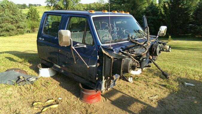

The new cab. Doors suck, but cab is really nice. Will be using my old doors as they're really nice. Got a rust free front clip as well! Will get new carpet and headliner and eventually would like the bucket seats rather than the benches! The bottom Will be coated in por15 as well

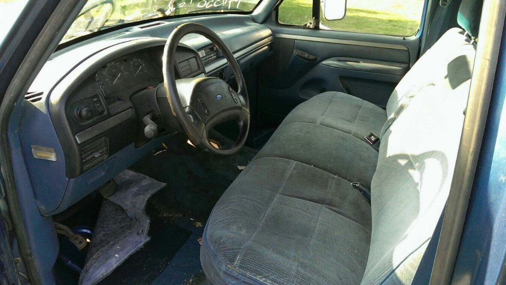

I am using the blue interior. just needs some new pieces. New carpet, headliner and driver front door panel needs replaced

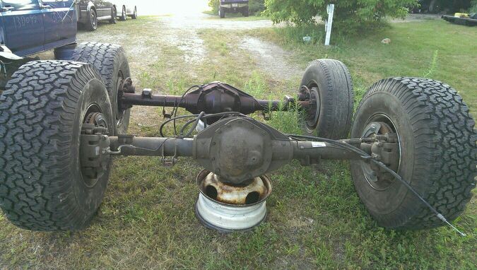

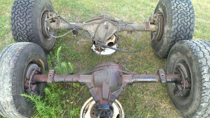

Here's a comparison of the dodge aam 1150 and the gm 1150
Gm close
Dodge close
Dodge left, gm right
Now you can understand why I switched to the dodge version. Also the dodge version has a speed sensor whereas the gm doors not

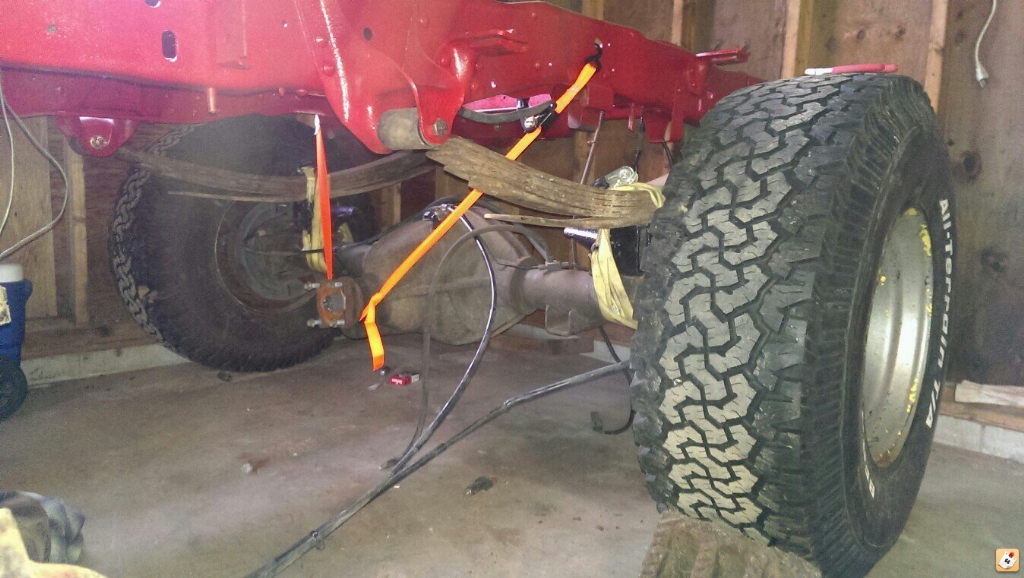

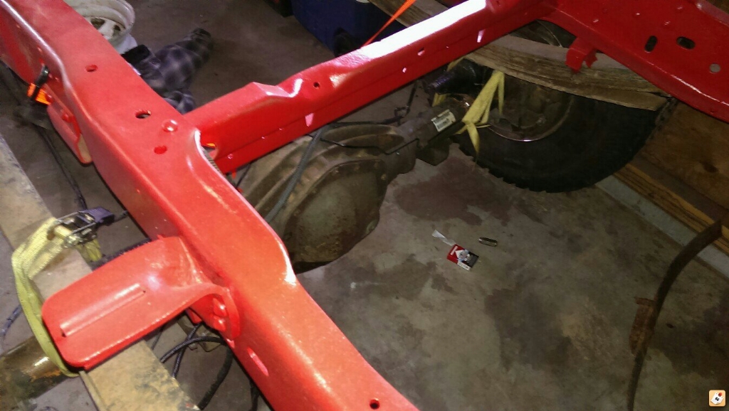

Got the new rear axle in Saturday. Stock suspension with 35s. Top off the roof is at 7 feet so it stands pretty tall. Going to order some pmf 4" rear blocks to replace the factory blocks. Decided against lifting it due to its current height.
Yes that is a Rockwell 2.5 ton laying under it and that is the turbo I will be running. I still have to por15 the axles and leaf springs, but I needed to get it under to make sure it was right
