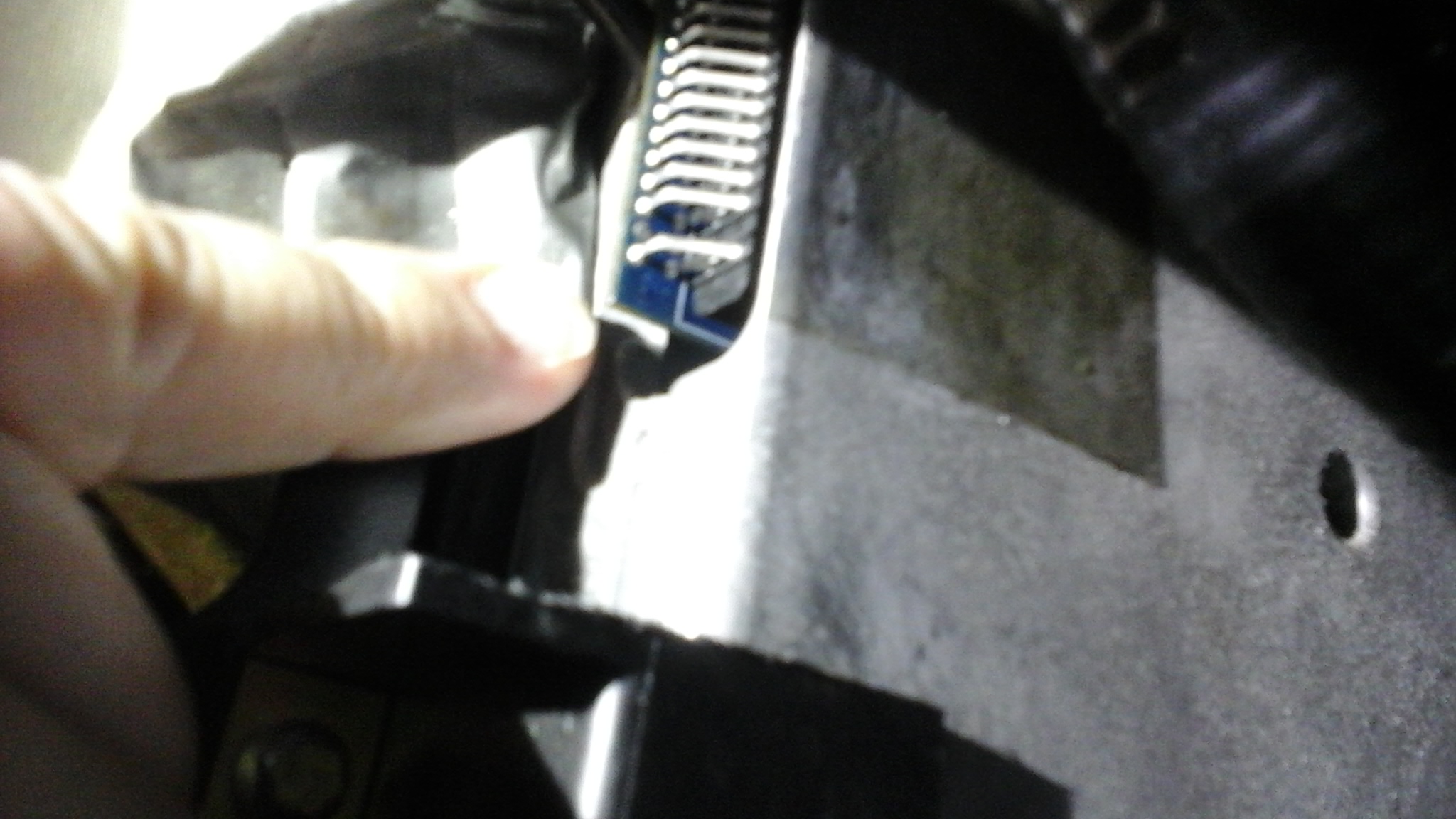

Trying to add a picture. OK there is a black wire running behind this piece I am pointing to, is r
That the chip? When I wiggle this wire it's loose.

I can only see 2 bolts holding on the grey cover to where the chip is. That has to come off to get to the chip i assume?

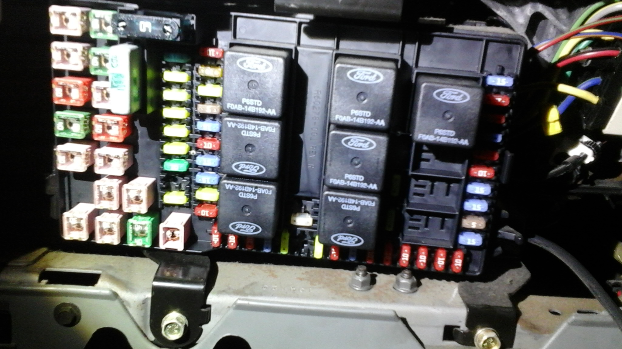

Ok holy smokes i have a update. I must have read wrong about cig lighter and obd2 port being on same fuse. My scanner powers up but the cig lighter isnt working. My cheapo scanner you dont have to plug up to cig lighter, just plug it up to obd2 port for power. i will post a pic of the fuse panel which is confusing to me as nothing is numbered, i did a search and found there are a couple different panel setups in these trucks. Its on my tablet so i will post it up

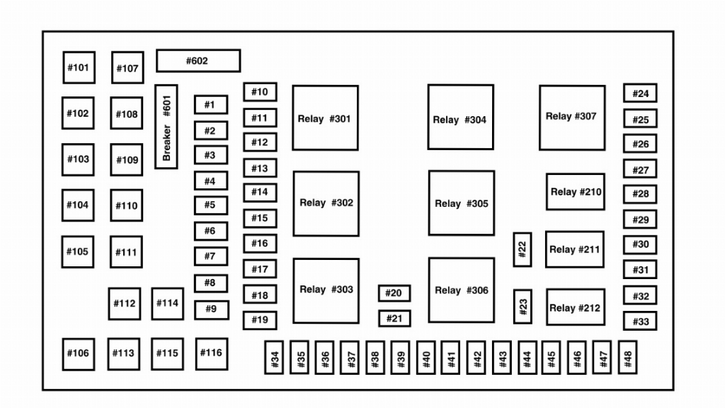

Not sure which one it is again, I know it's a 20amp. Would anyone know where I can find a chart telling me what's what?
