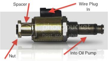

Look down in the valley. You will find a wire connected to a round thing with a hole in the middle. You will also find a spacer about an inch tall. you should also find a tin nut. put those back on the IPR and all will be good to go.

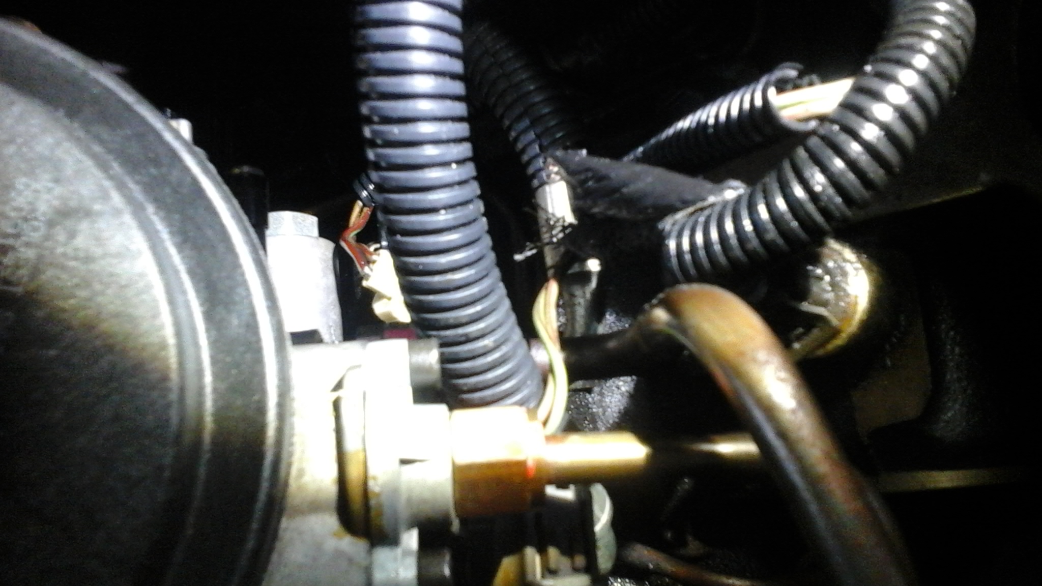

Well it looks like that piece is ok, the wires to that connector wiggle back and forth but I guess that's normal. It's all hooked up.
Check the wires in the split loom. Years of oil and fuel leaks will break down the insulation and cause what happened to my harness.

Have you tried unplugging the icp yet? In your first picture, it looks like the old style and like its leaking as well. You could be shorting your vref enought to not start if its leaking extremely bad.

I sure will because at the connector they are slick with oil and whatever. Have to see how far they go or where they run to.

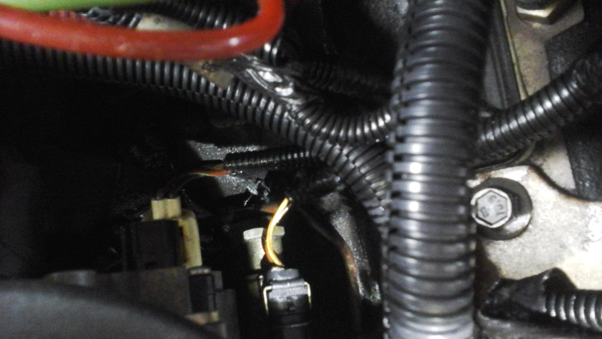

How does your harness look?

Rusty i wont lie man i have no idea what i am looking at. What wires are those?
For me, it was the plug for the IPR. Find where is connects and pull back the split loom and inspect the wires. Mine were completely bare copper and shorted the circuit causing my no start.
