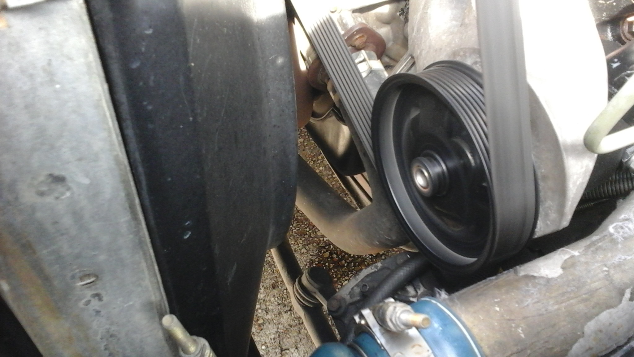

Well not really. The belts are squeaking when cold and this morning I noticed something leaking under front of engine and it's not oil could that be water pump?
Turbosuzuki
May 1, 2012
403
Louisiana
It's leaking off the cross member behind the radiator hose
