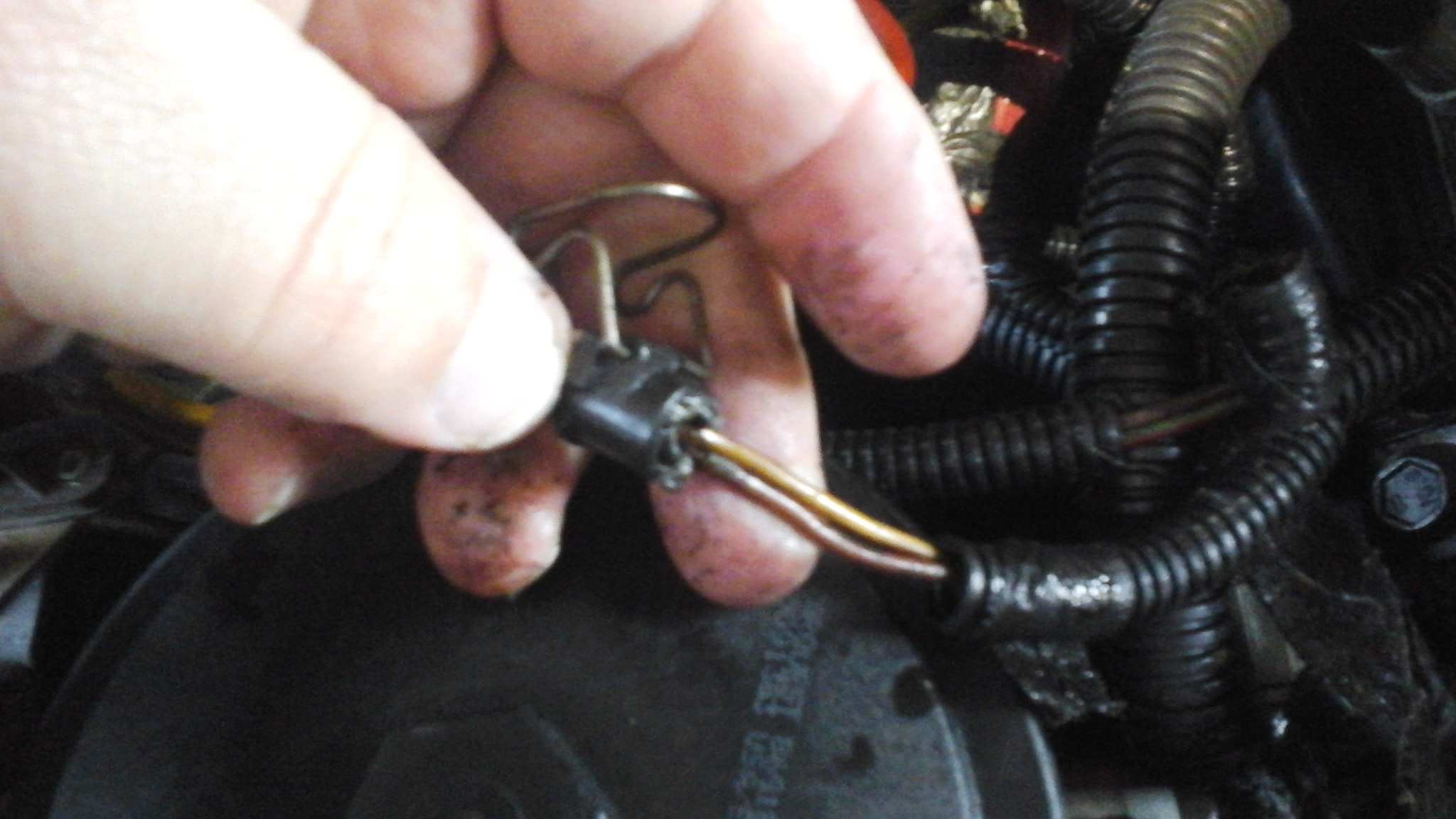

Have you checked your IPR harness? Mine looked like this and caused a no start.
I replaced it and all was good.
Rusty
You can see the bare copper at the connector.
Rusty

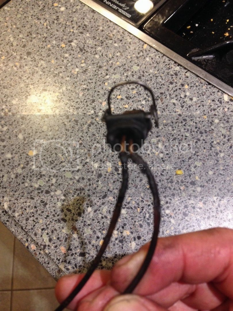

I don't see bare wires but it's full of oil. Now the piece it's connected to seems loose. I can wiggle it back and forth I thought the sensor it self was loose but just the wire connector.

Replace it and make sure the tin nut in the IPR is snug. That tin nut can also be replaced with a 1/2-20 jam nut, loctite it in place.
Rusty
The plastic connector on the ipr will move a little bit, does not mean it's bad.

OK what about replacing the sensor also? The nut Is tight on there.
The IPR may be part of or your whole problem. At the age and mileage of these trucks, it will only hurt your pocketbook earlier than later to replace it, IMO. I'd switch to the 1/2-20 nut at the same time and eliminate that tin nut.
Rusty

I just had to replace mine. I borrowed one that I knew was good and swapped it into my motor and it fired up. That's how I knew. If you've got oil in your icp sensor you'll need a new one of those as well.

Yes when I unplugged the icp sensor the connector was full of oil.

Yep. You'll need a new or known good one also. And clean the wire connector with some sort of a contact cleaner to get the oil off.
