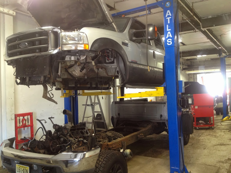

Doesn't look like I will be making it to the MPD Dyno day after all.... Between an overload of work starting this week and my truck is finally getting studded and gaskets as of today, and prepping the house for the baby (just found out its a BOY! WOOHOOO!), I've got too much to do and not enough time.
While the heads are getting milled should I have them do a valve job? I'm not sure what goes into it but its not all that cheap. Milling the heads is about $350. Milling and valve job is about $850. Is it worth it?

Have you cut corners on the rest of the build?

Man, who is doing the machining on those heads?
When my heads went in I got:
Pressure test: $80.00
Valve Job: $175.00
Mill heads: $80.00
Valve Seals: $80.00
Pressure wash: $30.00
Total: $445.00
To answer your question, I would definitely go ahead and do that at this point. You have it all apart now, might as well make it right...

shame ya won't be at MPD :/ I say do the valve job if it needs to be done. Fix what needs to be fixed. Might as well have everything refreshed while it's all apart

Im sure the valve guides all have play in them, worth it to get it all done now.

Those prices are right inline in what I get them done for Florida

So I got a PM from a guy who said he had a set of 225CC injectors sitting on the shelf of his shop and would be willing to send them for me to try. Long story short, they never showed up. Had they showed up in time to put the truck back together I would have made every effort to get down to MPD's event.
The heads got back to the shop today, cant wait to have my truck back on the road anyway...
Wish I had the cash for a Regulated Return kit while the cab is off....
