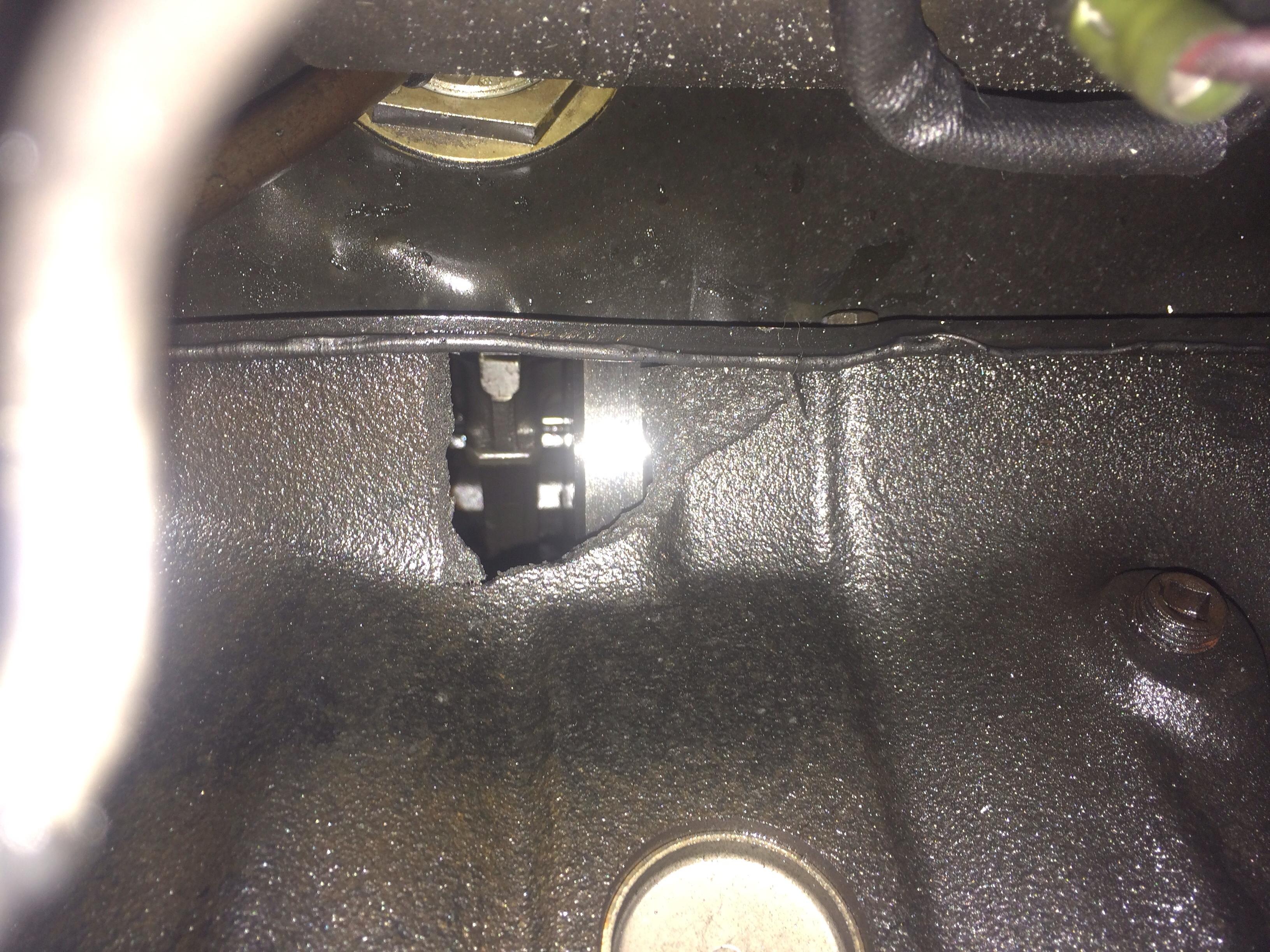

Soooo still waiting on replies for parts :(, going to half fill, main studs , head studs , cut and coated pistons, Carrillo , balanced , girdle , cryo
Hopefully it'll hold a 1000hp once , not sure on the fire or o-ring yet having a hard time finding a machine shop I trust in nor cal most won't touch a diesel and shipping is a hassle and a lot of money lol , any more info do's or don't are appreciated!

Fire ring is your only option, nothing else will live long in your application.
