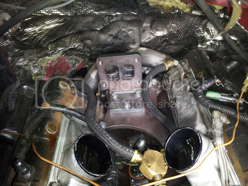

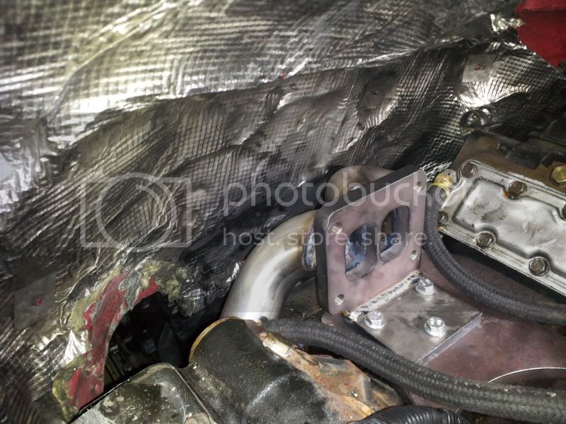

Well its installed and running flawlessly at the moment. here are some install pics:
My impressions:
Well ive only driven it a couple days and im currently ONLY running economy tunes that are pulled back a little bit, so the fueling is definitely not there yet. But i can say this, it spools quicker and flows LOTS more than the HX. In fact it runs 100% clean on a tune that used to be pretty smokey (my economy tune). It is also dead quiet, i cant hardly ever hear it.
