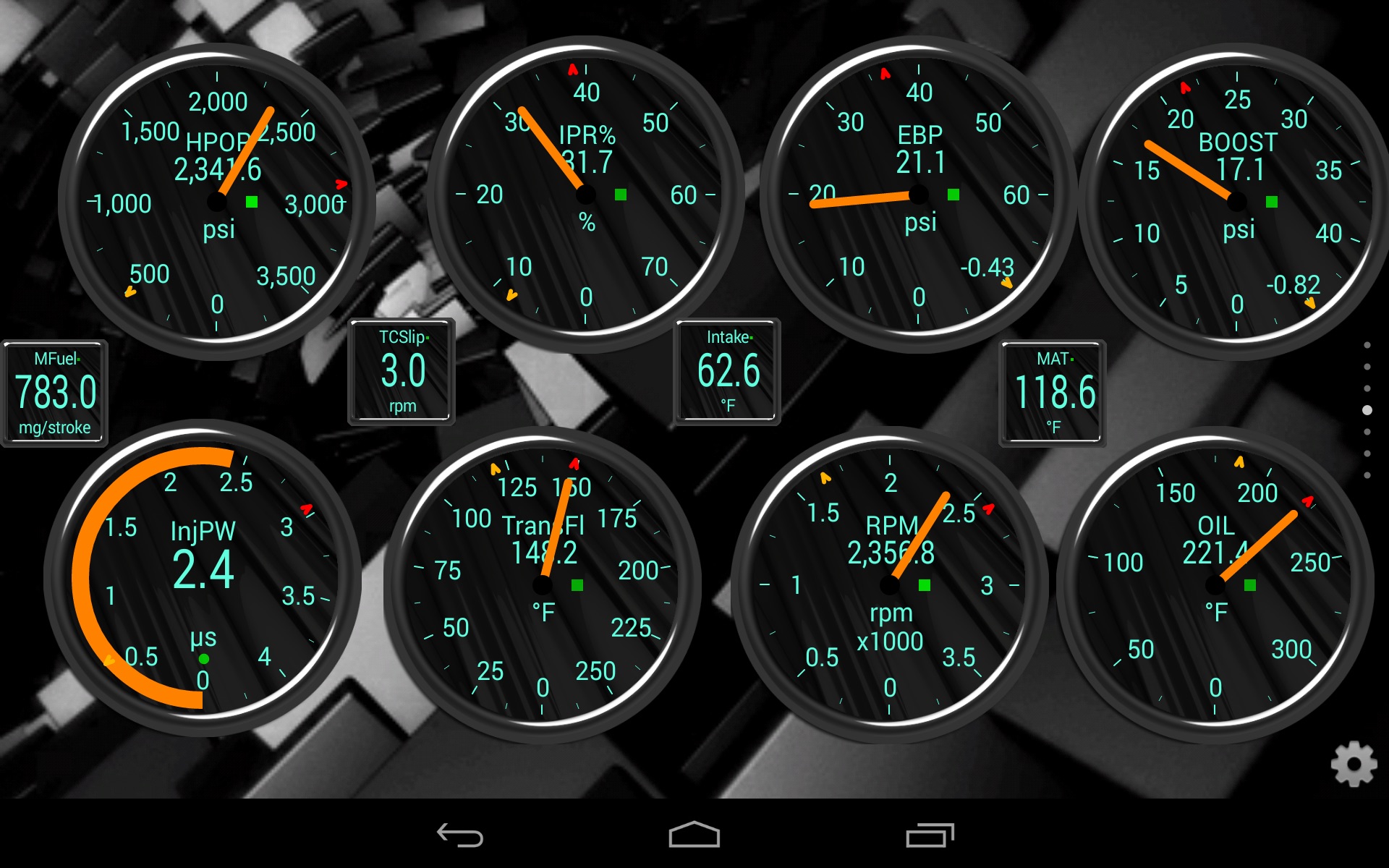

I'm having the same bad luck. 200/80's, 38r, WW2, 40hp tow (live tuned)=1300* egts and less speed pulling 10k up a grade than with stock turbo/sticks. And a intermittent rough idle.
What's boost and icp look like? All the live tuning in the world can't fix a mechanical deficiency.
ICP won't go past 40% at 3000psi. Boost about 42 at WOT, 17-19lbs in tow tune at 2500rpm maintaining 1200* Egts. Once spooled, drive pressure is close to 1:1 up to sensor limits (22 psi over boost regulator). Been to 2 different diesel shops and both say it's either the tuning, or injectors. I've logged tons of data with AE. At this point, I'm gonna cut my losses, and go with 175/80's and a BASB.

You could "cut" your losses and wind up in the same boat. Check for drive/boost leaks. Your icp #s look excellent. To be honest that setup should ***kin rip!
It should tow like a beast.

Leaks? Been there, done that. IH uppipes, no soot anywhere, pressurized the turbo inlet. Maybe the hybrids are just too much to tow with? (Here's where the guys with 300/200's tell me how they're towing 15k at 2000rpm and 1000* egts)
Here's a screen shot towing about 9k up 4-5% grade at 65ish mph. Egts right at 1200 on both banks. The EBP was same as boost right up until I took the pic. I guess my foot moved when I took the pic. Note the tattle tale arrows with ICP and IPR DC.

I have 250/200s and I dont have anything in the way of power deficiency towing as you called it.
I have a tow tune but I use the "race" tune all the time. Its been a while but I pulled about 15k with it and I used as much throttle as I cared to and mine was NOT hot...I ran up a 3% grade for 5 miles and it was 900ish degrees at 65mph. My stock injectors would have been 13-1400...
You got something effed up. Your setup should tow better than mine. Well from a tuning standpoint.
