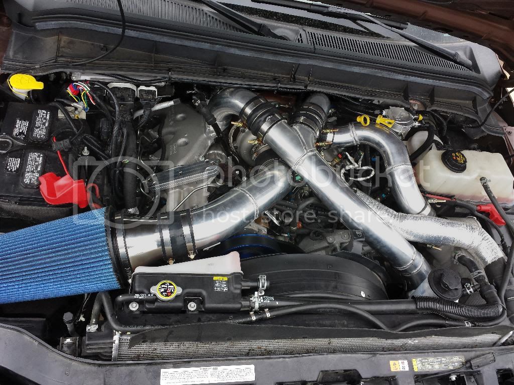

I had the stock charger out and the new one bolted down in a fragmented 4 hours. Another 3 hours to cut and fit the hoses install fuel bowl, charge piping, etc. Probably could do another one much faster.
Thanks Erik. Probably one of the most pleasing street setups we've done, if not the best one because of the 6.7's capabilities. Kind of hard to beat a setup like this. The smoke free power is to die for.
I'll probably strap up a go pro to show the cleanliness out the tailpipe.

Not much left to do in the engine bay. Coolant reroute hose when Steves EGR delete arrives and hit the pipes with a cotton buffing wheel.
Here's a video on calibration 3 that I sent Gary. 3/4 throttle after 20mph. Didnt want to just step on it and throw a bunch of torque at the motor. No mcc unlock yet.
The rad hose that comes out of the side of the rad towards the bottom on the passenger side. Where did you reroute that too? I see you just dead end the one end coming off of the coolant tank.
