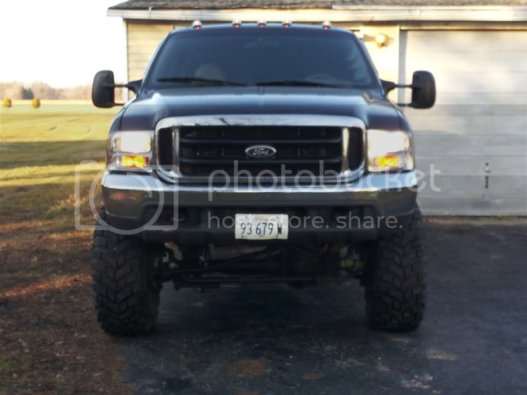

I tow 50k miles a year mang. Just asking questions.because.ive.never had.trouble like that unless something was not working right. My trailer is 12' tall inside so im always pushing.TONS of air.
Not the greatest but you get the idea. Its an aerodynamic nightmare.
This is my towpig. 12 duramax cclb. It runs pretty hot.
Last time my truck towed was setup like this. 37s, stg 2s and 38r. Ran cool. Cooler than the dmax ever did.
