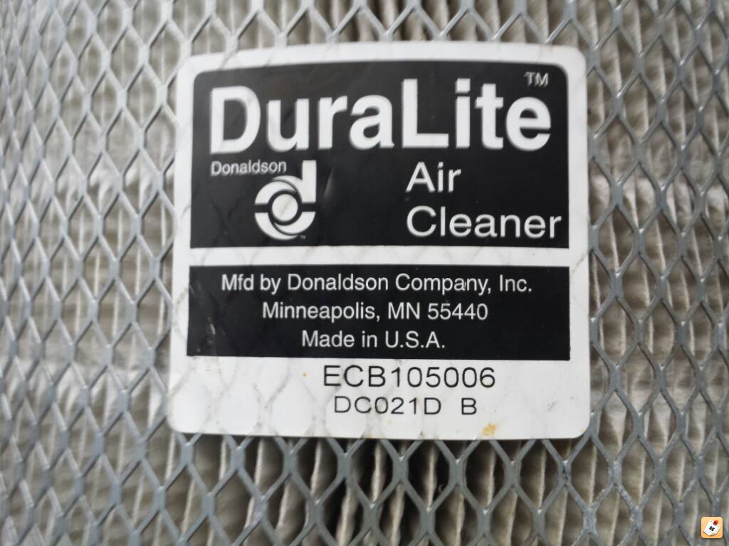

Sooooo.... I may be going back to my redneckish ways with this but this filter is the next size bigger the the 6637 filter we all have used on the ole 7.3s but the way the filter box is set up on the 6.7 is just horid. I swep a .25 inch layer of dirt/dust out so I pulled all the components out to see if this filter would fit... its 10.5 inch wide by 10.5 inch long with 2inch deep pleets..... well bigger then the 6637... but fits nicely.... prolly make it happen the next time I need a filter...

When the AFe cold air intakes first came out they were throwing some sort of code. I wonder if this setup will? If it doesn't we might have something here.

I refuse to run a cone/oiled filter.... this is the only option ill try... if it throws a code I guess ill just have to suck it up and figure out how to keep all the dam dirt/dust out of the box... 15k miles 90% freeway and the stock filter was matted across 3/4 of it...
