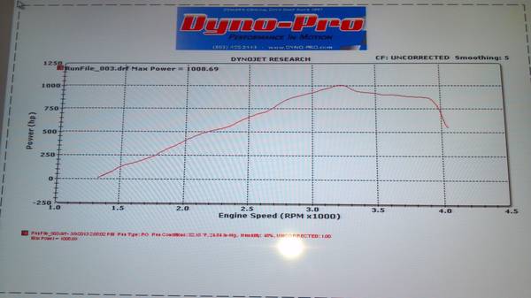

Here ya go, Mike. Thanks for the vid Erik.
I'll probably keep the nitrous on the truck long enough to guarantee myself an 11, then pull it off, and stick to fuel only goals. As far as I'm concerned, this is the limit of my stock rods.

Right on - great numbers!
What are your fuel only goals going to be?

As far as I can go with a 66/88 combo and 110's eventually. There are still a bunch of turbo configurations I need to do before that though. If I get close to 1000 uncorrected without spray, I'll have to dial it back a bit to keep it together, but otherwise I'll just keep playing with it, trying new stuff.
Deffintetly not the limit of stock rods we just pulled the motor out of kingkong and all rods where straight from lastyear

I'm glad to know those rods are surviving well, especially considering it made 1300+ uncorrected iirc. I guess I should clarify that I'm more worried about torque, especially bottom end torque as far as bending the rods, which generally seems to be less on big singles then with how my setup works. I can't afford to ruin my motor, so I will leave the limit pushing to those brave/ financially stable enough.
