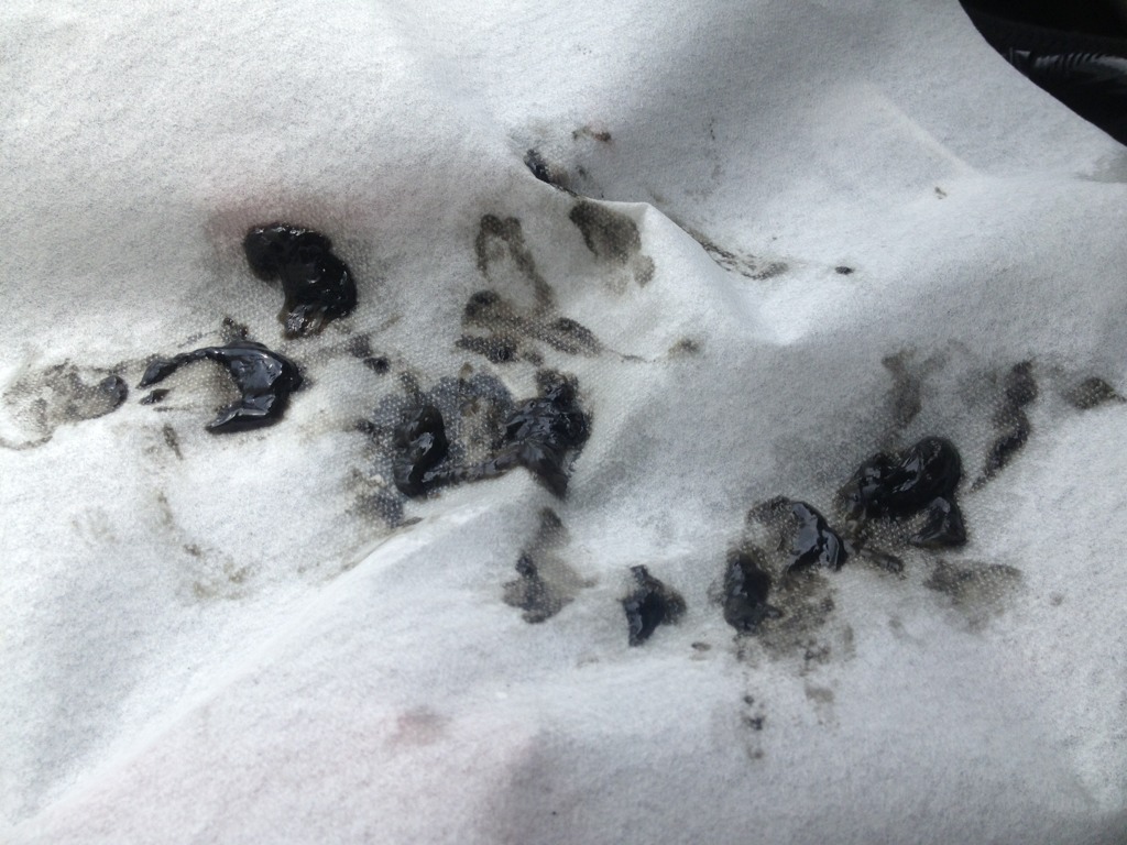

this is a long shot but i saw a 6.4 that had a leaking front cover and the first place i noticed an issue was in the ccv tube, it had sludge just like webb06's picture

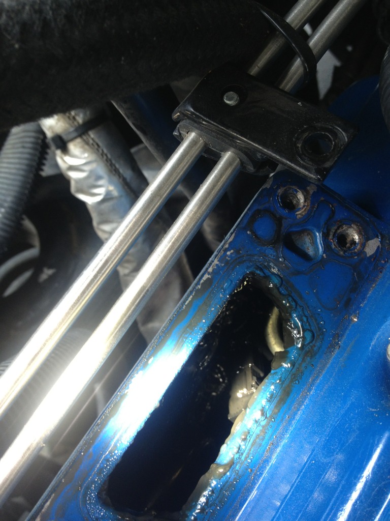

Pulled the ccv canister off and everything is covered in the black jelly stuff. Oil filter has coolant in it too.
Where do I even begin to find the source?

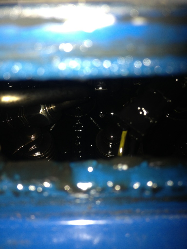

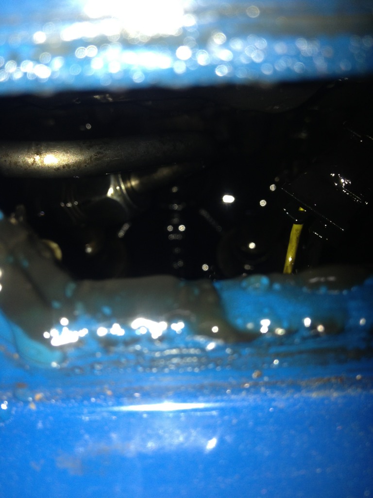

Pulled the oil pan and got enough room to see inside and pressurized the cooling system. Can see water droplets dripping off the rods bolts. So add me to the cracked block list I guess....
