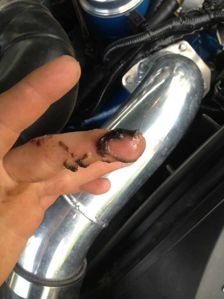

Well just checked the oil and coolant and pulled the oil fill cap off. Coolant is low. Oil seemed fine. Oil fill cap had black sludge on it....that is not good! Cracked block? Cracked head? Oil and coolant temps show to be fine, maybe 2-3 degrees difference. Truck runs fine. Minus the sludge I just found

I hate to be the one to say it ....... But black "pudding" on the oil fill is tell tale antifreeze in the oil. Most likely cracked block.
For your sake I hope not!

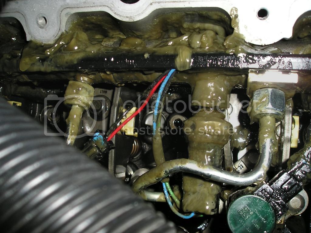

Remove the oil filler/CCV and look around under the valve cover. Hopefully you WONT find this.
[/URL]
