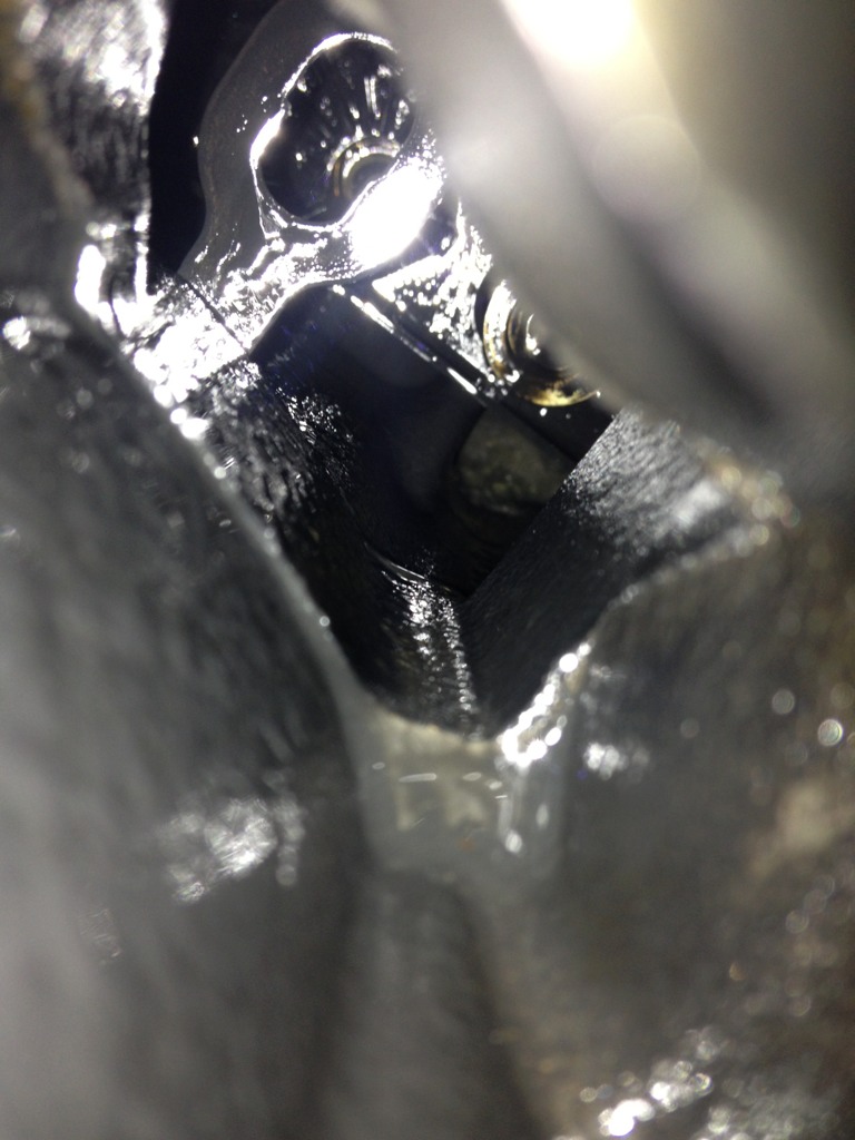

I wanted to be 100% sure it's the block so I pulled everything off the drivers side head with the cab still down. Pressurized it up and I can see where it's leaking. The second stud back, separates #2 and #4, on the top row. It's down in the lifter valley. I can see a small puddle and every few seconds I can watch a water droplet roll down.
Time to get the cab off and engine out...yippee

Here's the best picture I can get. Can't see the crack just the puddle. I'll get better pictures when the engine is apart
