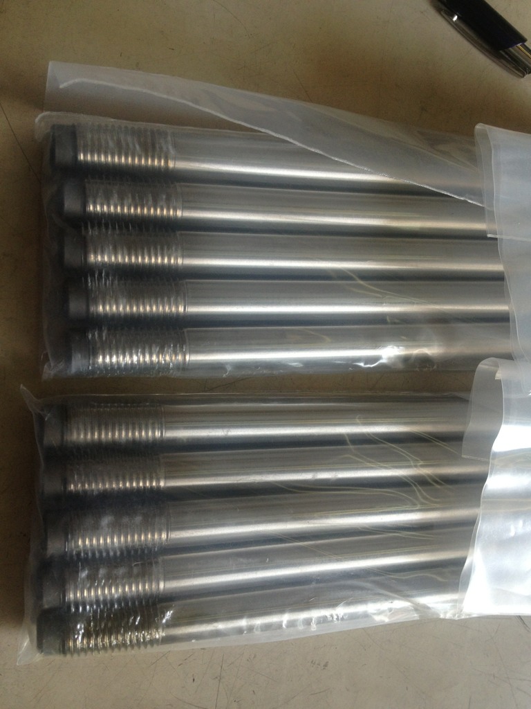

Sent the block to the machine shop to get the deck surfaced. Crank is getting polished and rods reconditioned. Once the pistons make it in I'll have it all balanced
Here's the custom aged elite studs

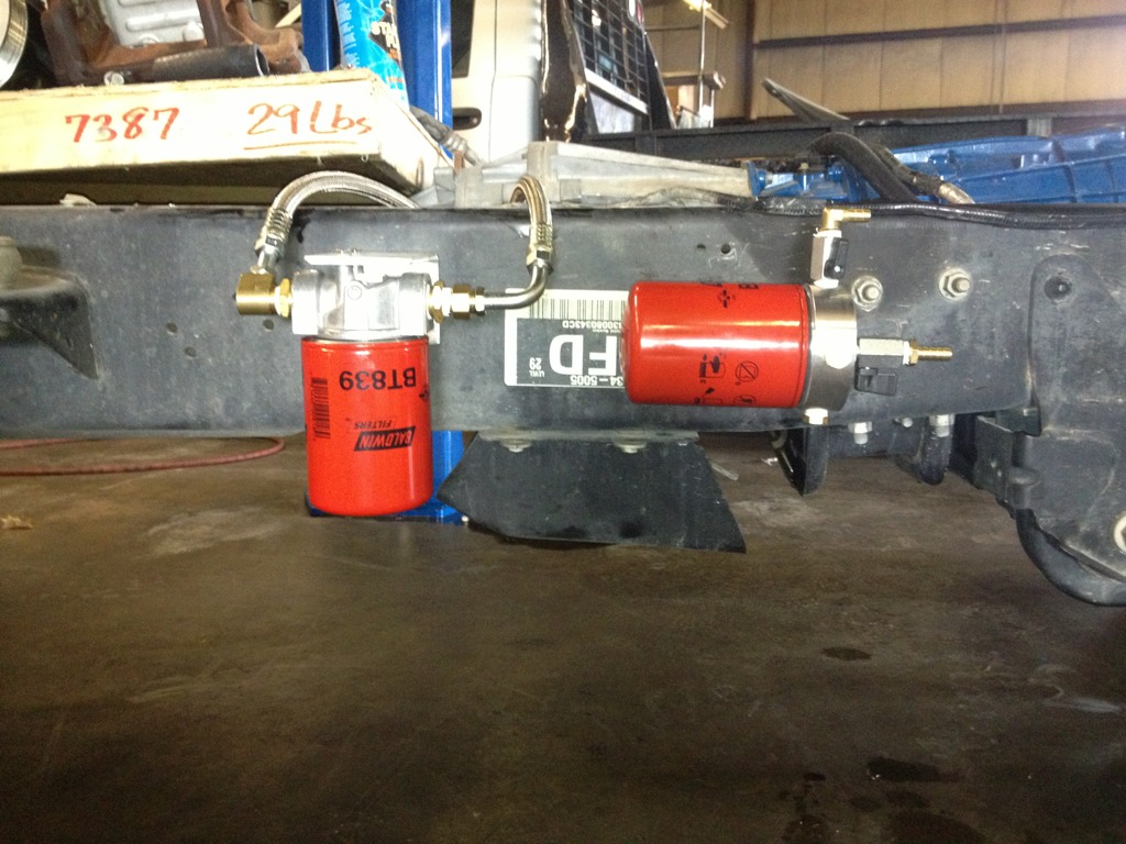

Coolant and trans filter also came in.

In case you haven't already planned on it, be sure to deck the tops of the pistons to match the block. You should have a very nice setup when done.

Checked in to that. Been told they will be fine. And told the machine shop to let me know if they take off more than .005 so I can adjust accordingly

Filter setups real nice. Off topic but I believe your skid plate is on backwards.
