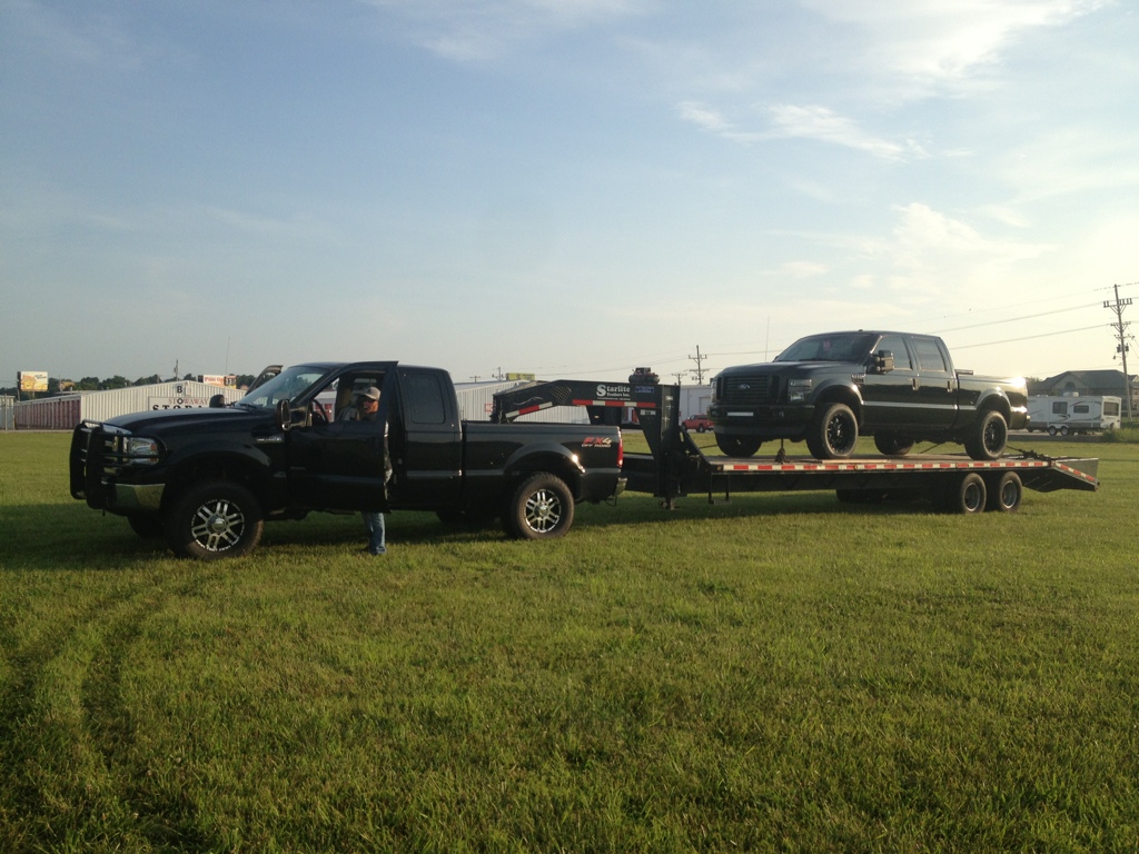

Disaster has struck once again on the truck. Headed home from the lake this weekend and the front fuel pump locked up, lost the bolt, pulley came off, belt came off. Went home for a gooseneck and trailered it home. At first I didn't think the pump was locked up. But after getting a ratchet and socket on it, turns about 1/2 a turn each way then it won't budge anymore. This pump has less than 2000 miles on it since I swapped it in not to long ago. There are metal flakes in the fuel system, injectors 3 and 7 are already showing signs of laying out. So I'm not sure where to go from here. Maybe I can get ford to warranty all needed parts but I'm not counting on it. View attachment 29313
That sucks....you have had enough problems already.
I can't believe how much of a problem these pumps are. It is really scarry since you are running duals without huge nozzles so your duty cycle should have been relatively low for each pump.
