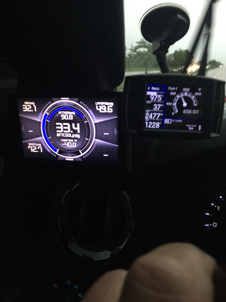

Edge CTS2 stand alone non-OBD2 harness not available until now. Works like a champ.
jcain
Jul 14, 2013
2,017
I'm not quite sure with what you mean? Are you running the EAS stand alone sensors or did you piggy back the obd2?
dseitler
Feb 2, 2014
812
Royal Palm Beach, FL
Stand alone. Edge has not released the 12v cable so you can run the new CTS2 stand alone like the old one. The only way to run it now is with the OBD11 connector.
dseitler
Feb 2, 2014
812
So far the best one I have tested. Quick spool and recovers faster than any of the other Turbo's I have had on the 6.7. Absolutely no Turbo bark back into the intake. I have towed several loads at 6500 lbs and it has performed better than expected. Picks up right from the bottom and I have been impressed with its ability to bring the boost up quick to maintain speed. Towed one load at 11,000 with the same results. Have not had a chance to hook on to the big trailer yet with the 17K on deck. Maybe next week.
Should get a chance to shoot a few more video's now that the rain has seemed to stop for a few days.
Did hook up the boost sensor in the Turbo housing to get a reading off of the Turbo directly. Peek boost so far has been 53lbs but I have yet to run any of my big or top fuel tunes.
