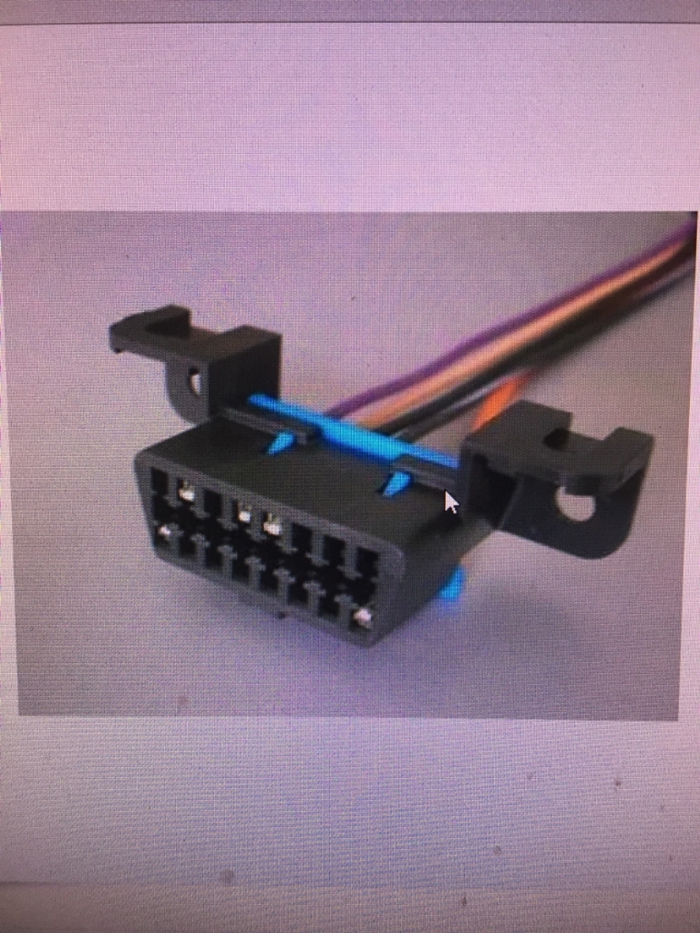

I can see if I have another Female plug and get a part number off of it. Google it and see if I can find them and give you the info. From there it gets butt connected just like the one you have now and I can give you the diagram with the colors.
If its pretty easy let me know. I'm probably going to upgrade to the CTS2 before they come out with the 12v kit for them.

Ok this is what you can do. Purchase eBay item No 221859768467.
All you need is the wires that are in Pins 16, 4 and 5. The rest of the wires use a small flat screw driver and remove.
Use the cable that is supplied with the CTS2 and plug it into the new connector. Put 12v ignition source on pin 16 and ground pins 4 and 5. It will now turn on with the key switch and work with your existing EAS Sensors. At least it did and still does on my truck.

Perfect ! Thanks a lot Dan
