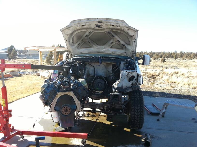

Well 3 hours later there she is, we will start stripping down momentarily. Ill post oics of what we find.
from my butt

If you get somebody you dont have to babysit, you can yank.em that quick. Took me twice that long but I was by myself and had to quit due to loss of daylight. Im excited to see this unfold.

Ive pulled a few motors in my day, I may be young but the old man has been doing it for longer than ive been alive. We dicked around this time or it woukd have been faster....

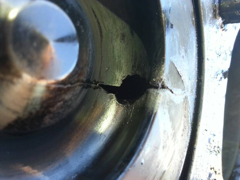

well survey says its a hole in the piston. Started from a couple of cracks.. nozzles are all in good visable shape we will see what whoever he decides to have build them says on that for sure though. Motors torn down, ill be dropping off heads tomorrow for a rebuild. Hopefully in a couple weeks we will have him up and running again.
from my butt

Damn, only 3 hours? I need to have you guys come over here and pull mine so I can swap the oil pan.
Its really not hard to yard them out, I honestly think having a bit of a lift makes it easier.
We removed the up pipes before pulling the motor because someone forgot the extensions to unbolt the trans... That took 30 minutes more then it needed too...
Lots of practice
Har Har...
Of course around my house we do our own work, we dont send our trucks to a shop to have a sensor replaced...:poke:

FORD7.3
450
Why not mix it up and go with something pius comes up with for your setup?? And, hard to tell by the pictures but is that a little contact to the side of the hole?? And how did the heads look??
