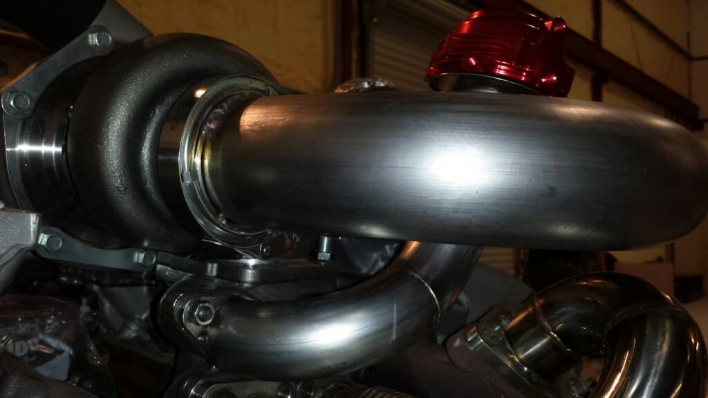

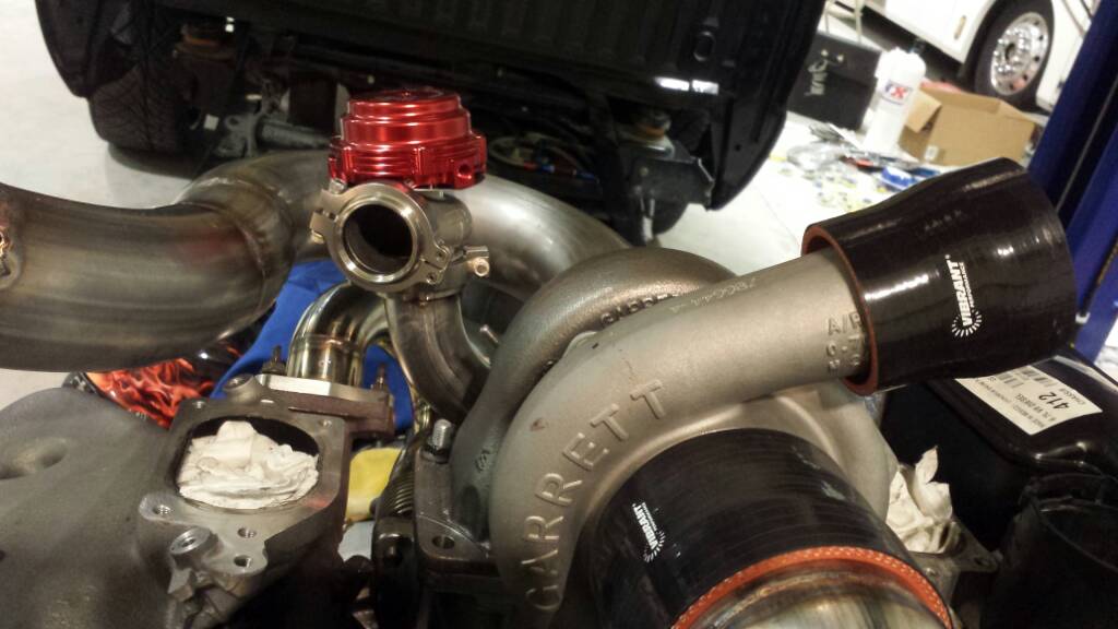

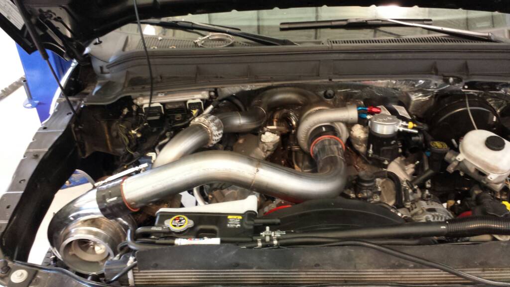

After 4 days, 5 or 6 different primary positions, finally came up with something we liked. This particular primary charger has a massive compressor cover; we could never get hood, valve cover, fuel line, battery box clearances that we needed because of the cover, so we pulled the battery box. Will be relocating the body harness behind the fender, up and out of the way along with the glow plug module and fuse box. Should make for a clean install

Ha ha. I'm loving the progress you guys are making on this. Nice fab work and layout. I know that stuff is very time consuming, but you're clearly up to the task.
