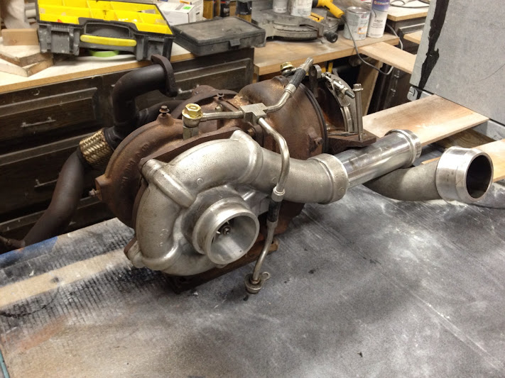

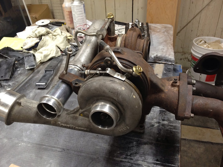

Turns out there is a local private shop who has a tube bender who should be able to do the job. Other wise I am thinking of doing a sleeved joint and tacking it till i am sure of the length, then fully weld it when ready. I would at least do this for the drivers side. The passenger side may be a bit easier as I think I can use the EGR replacement up pipe I have to "adapt" might be easier than the drivers side at least.
Is there going to be a clearance issure with the 6.0 thermostat housing on the front cover and the location of high pressure turbocharger outlet (where the intercooler pipe on the 6.4 connects)
I am looking at pic's to try to follow you here, are you referring to right next to the upper fuel filter? That is roughly where the output of the high pressure turbo is. it may be a tight squeeze there but I cannot tell for sure till I get the turbo's sitting in there. I do foresee using v-band assemblies right on the turbo since, I had a huge issue not that long ago with boots blowing off every time I hit 15psi. Considering that these turbo's will can make upwards of 50psi I see boots being a major weakness, and I hate driving 500ft before i have to pull over to re-attach boots.

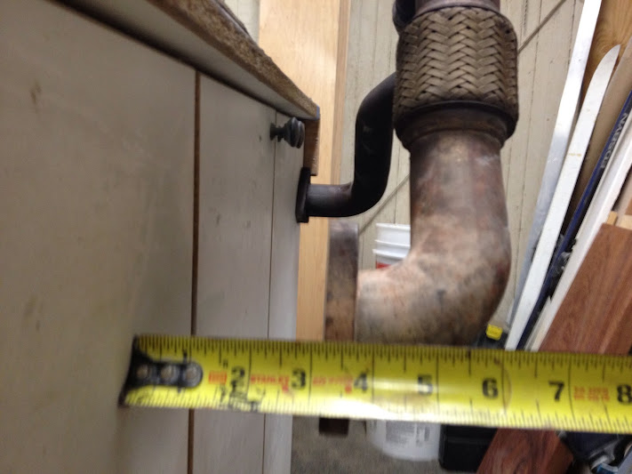

As I was bolting all the stuff together I noticed that the flanges for the manifolds are in different positions front to rear (see images with tape measure). Do the 6.0 manifolds follow the same sort of off set?

well, the 6.4 manifolds should directly bolt on, and give you the exact offset you need, but that's the difference of how much further forward the exhaust ports are from right to left. The 6.0 manifolds handle this mostly by having a longer passenger side manifold.

So if the passenger side manifold is longer, then the straight section before the 90* MIGHT line up properly? If this is the case i think i'll be able to pull off doing cab on up pipes, wont be easy but it will be do-able.

yup, you could cut and shorten the 6.4 manifolds up by the flange as well and bring the offset in so you can cut and weld the lower portion of the 6.0 manifold onto the 6.4 pipe, but thats a maybe as I havent physically compared them side by side. But honestly if youre doing all that fab work, just buy the material and make a set of up pipes to fit the 6.0 manifolds. I should have a mock motor this weekend bud, you're more than welcome to come on up here and figure this stuff out without the cab being in the way. My buddy is a welder by trade and it pretty good at fab work, I can se if he's willing to help out as well.
