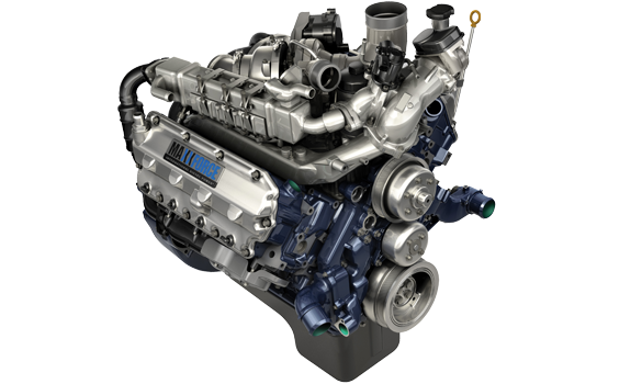

I was reading up on the 6.0 defense motor and looks like it uses what looks like maybe the same actuator off of the 6.4. Its still hydraulic injected. Just wonder if something off it would work.

Matt, I tried to look up some info on the 6.0 defense motor but could not find much. Much less anything about parts. Have a link?
