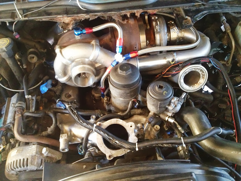

Here is today's finish point, should be ready to start it up by wednesday night assuming a couple parts show up as expected.

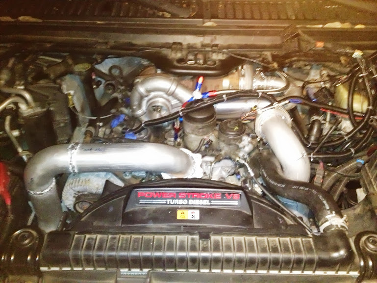

Another photo update. Tomorrow I hope to make the pre-turbo piping and then finish all the welds. Wednesdays schedule should be connecting all the electronics up and then connecting the down-pipe to the exhaust then cross my fingers.

01PSD
Sep 30, 2011
4,255
Smithfield, NC
Cant really tell.. But how much room is available for piping to the compressor inlet? Looks extremely tight

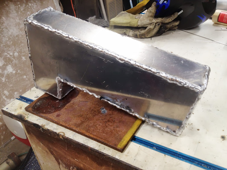

Maybe I missed it...but were is the coolant tank going? I'm sure it'll be an aftermarket one like a Canton tank right?
TheReelMuhcoy
Jul 24, 2012
567
New Jersey
Yes compressor inlet pipe will be very tight. I am not 100% certain yet but I my try to sneak it between the oil filter and intake elbow to the manifold, and maintain stock location (obviously different orientation though).
As for the coolant tank, it will not be moving but, I will be fabing one tonight from aluminum plate.

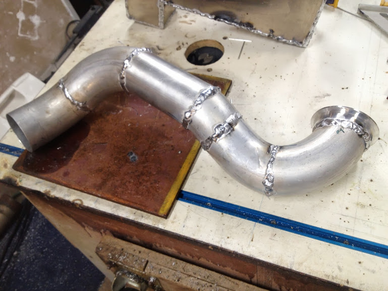

All the piping is tack welded, but I ran out of gas. No, literally, I ran out of argon gas :fustrate: Tomorrow is another day... I am really starting to get a hang of TIGing, too bad i will have perfected my technique by the end of this project. :shrug:
Here is a couple photo's of tonight's work including a better shot of the last image of the engine compartment.
