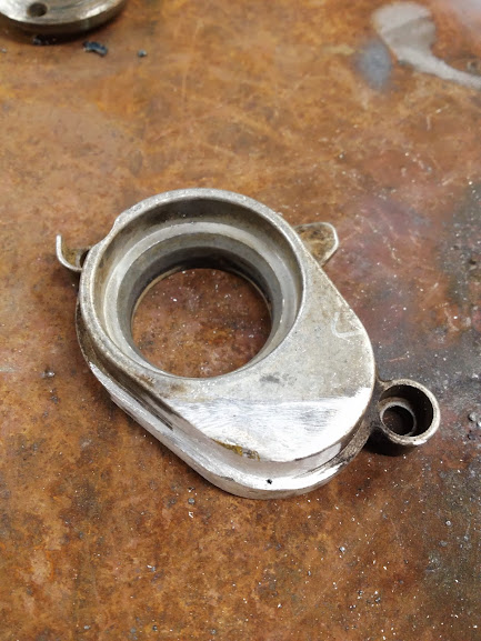

just got these back from the machine shop, for the turbo oil drainage.
Truck is just sitting and waiting to get rolled into the shop for gaskets, studs and injectors, then its time to start the build.

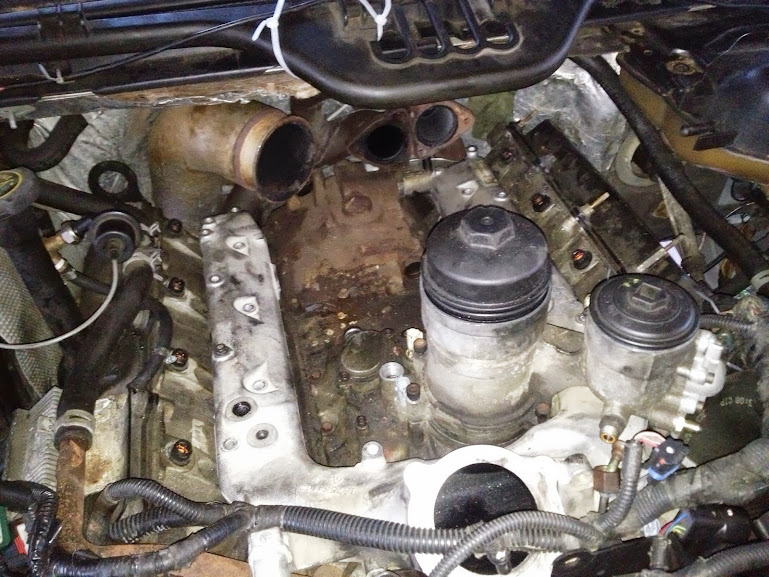

I have started to tear the truck down, and have run into some easily resolvable issues, except for one. I am trying to figure out how I will delete my EGR assuming that I will not be using the 6.0 Intake manifold.
Could I simply cap off both ends of the coolant run? If I completely stop the flow through the intake manifold will I be starving anything else for coolant?

Contact Powerstroked162 for a coolant re route line. Will route coolant from oil cooler to degas bottle.
Put a freeze plug in the port off of the front cover. Or you can tap the port and put a threaded plug in.

Could also hook in to heater hose on pass side

The coolant re-route will work, where ever I return it to. Thanks for the suggestion Morgan. I have all the dis-assembly done minus the down pipe. I currently have the passenger side 6.4 exhaust manifold and up pipe in place, so far everything is mounting and clearing fine. The 6.4 intake manifold needs some trimming of accessory mounting points, other than that, it lines up perfectly.
It seems like the early '03 6.0's have a different oil feed setup than the later ones. My feed line threads into the top of the oil cooler housing, looks like a strait cut 0-ring fitting. Anyone happen to know the thread size and pitch of this?

Its actually a snap to connect fitting. You should see a black plastic ring around it just below the line. When that ring is depressed it will release it.

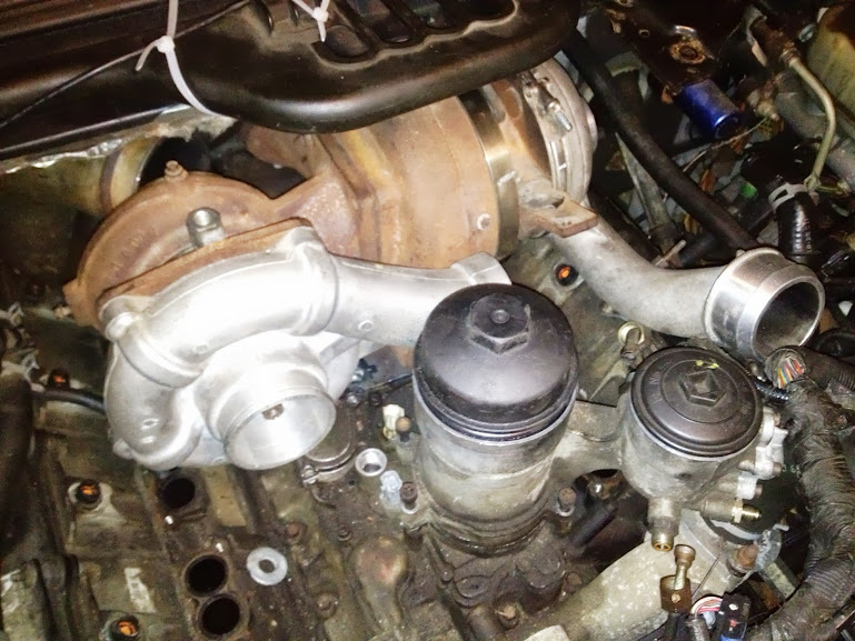

Progress Report 7/27/13
Let me know if you need this mockup motor bud
Greg, i have a mock up motor. its in my truck! :cursing:
Here are just a few pics for now. I've got a lot more work to go, but I feel the hardest part is over now. The pedestal is made and I can stop chitting my pants over whether things will fit or not, which there were several very close calls/minor modifications necessary. I am aiming to have the truck running next weekend.
I will just say this, my fabrication skills may not be of the same quality as some of you fella's on this site but, I will get 'er done. Enjoy, the pics for now and give me some feed back!!
:joy: :joy: Who cares about that stuff. If someone says something. Have them get their hands dirty, and attempt this. Been a long time coming for you
