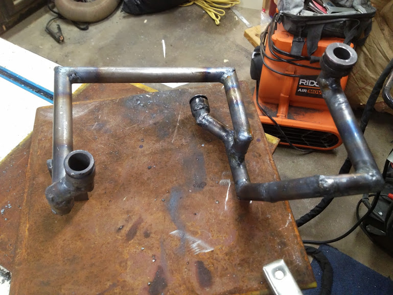

OK, so the oil drain tubes are officially the hardest part of this project now..... I am still working on sealing them up tight but ran out of argon gas.
Not looking like I will be completed this weekend, Should be close though.

I had thought of that, but how do you attach them to the turbo's? These turbo's have the same setup as the stock 6.0 drain line.
sleeps
May 6, 2012
442
Virginia Beach, Virginia
I'm sure it wouldn't be too difficult to find a fitting with the o-ring end and threaded on the other. Or just make it. That would take be a lot loss likely to crack and leak.
couldn't you take those ends you have, weld a clean piece of pipe to it ( reduce it down if needed) and thread the outside? Then its just fittings, y them together from the turbos and run the the third threaded piece and into the drain.
Edit: from a quick Google search for "o-ring turbo drain" something like this.
http://www.etektuning.com/integrated-engineering-2-7t-oil-drain-line-adapter-flange-kit/
TheReelMuhcoy
Jul 24, 2012
567
New Jersey
It's amazing how I searched for hours for a simple solution like that and turn up nothing. Then someone else does the same and PRESTO!! My only concern is that I would have to drill and tap the bolt for those fittings to work, which worried me because I have no idea what is on the inside of the turbo there.

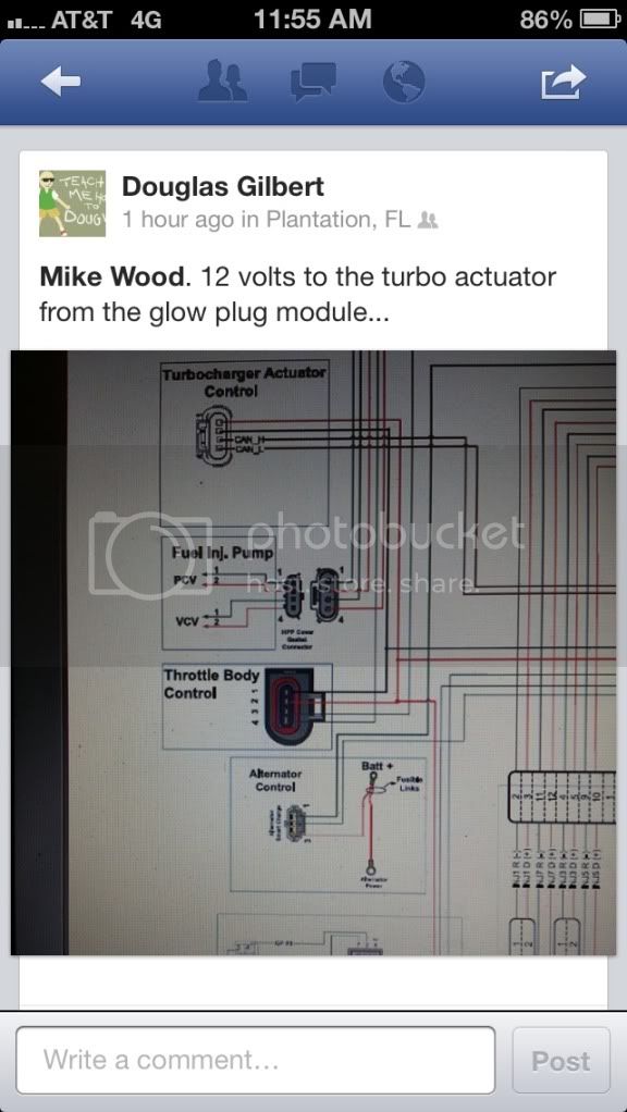

Doug is basically telling me that the turbo actuation this isn't that complicated...
I tried explaining my understanding (although probably a limited understanding) of differences between the 6.0 and 6.4 turbo actuation and was basically told I was an idiot. (Not verbatim, but you know Doug's charm).
12v = 12v. Hook it up and see which way the actuator arm moves etc....
Wish he would just reply here... Doug, if you read this... feel free to help out!
09stroker
1,300
Texas
Is this what you're referring to?
Cause the power source to the actuator doesn't matter as long as its 12v. As you can see the same wire powers several things. The problem is the actuator gets its information thru a CAN communication. You don't just add 12v to tell it what to do.
Mdub707
5,079
Mohawk NY
Yes, exactly. It's over my head. I think I even said that on like page 2 of this thread, but Doug felt the need to try and beat it into my head LOL.
Someone who fully understands it should relay the info along to Doug.

The 6.4 actuator has a miniature computer in it which decodes 1's and 0's (binary) and turns it into a voltage signal which it sends to a 3 phase stepper motor. They over did these things......
