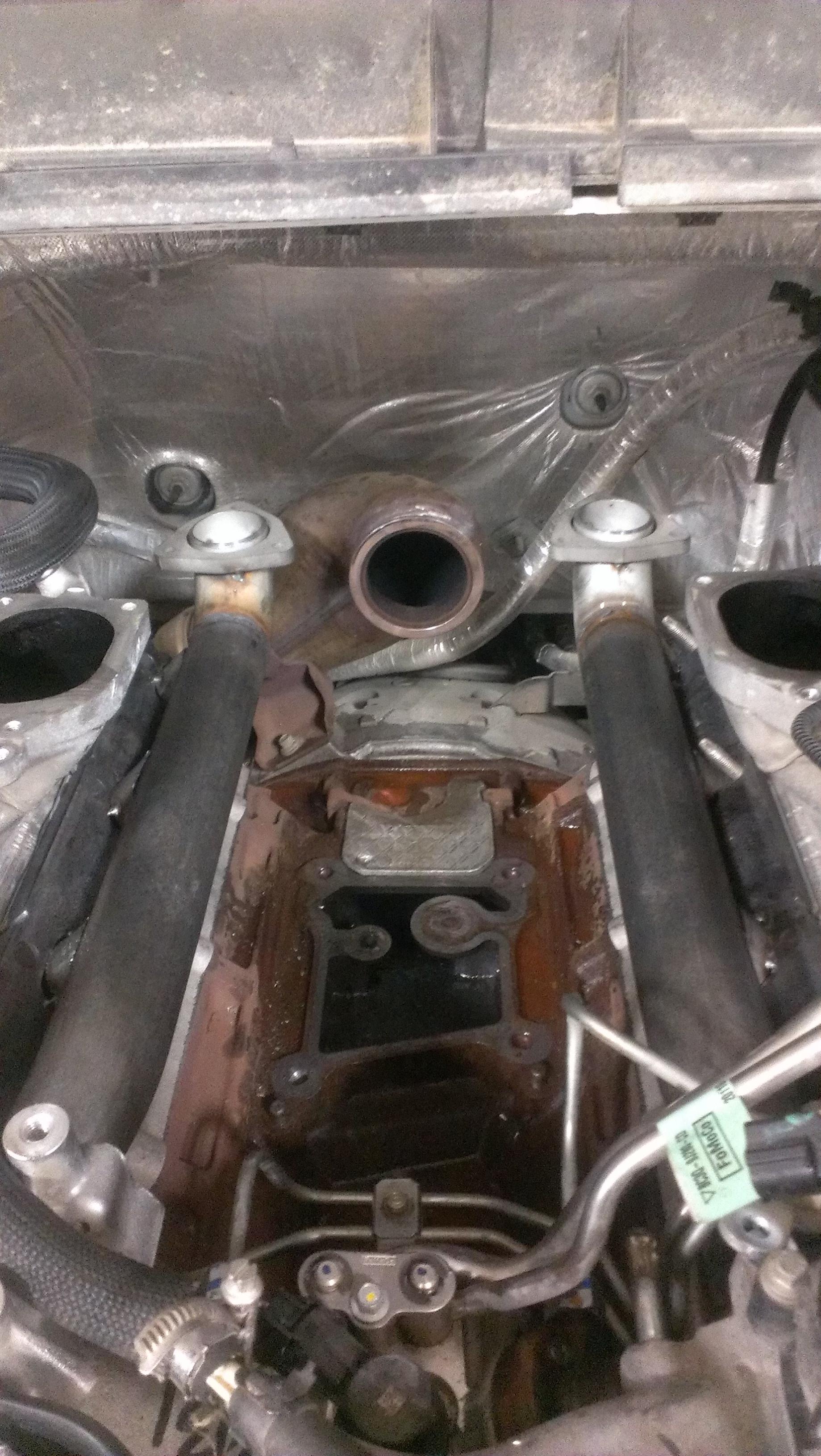

Post number 18, third photo. I've seen rats do less damage than that.
Holy hell.
Dan, you are definitely going to want to have that firewall blanket replaced by custome auto. You can buy a replacement from ford.

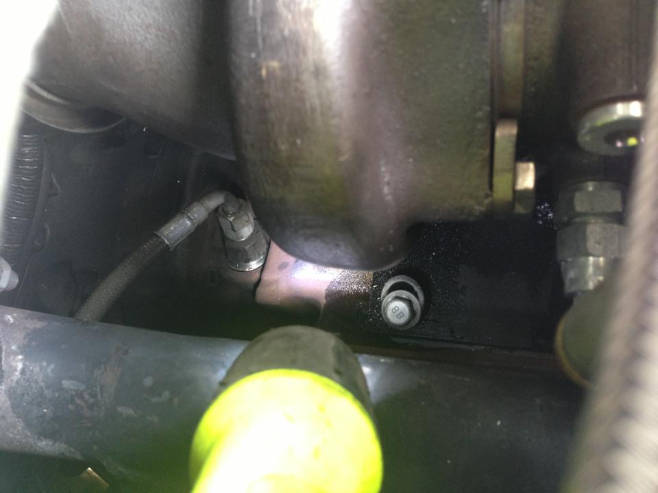

Morg, you notice in that pic that there was what looks like a pretty knarly exhaust leak at the header flange? Guess those "awesome" CFD headers aren't so awesome lol

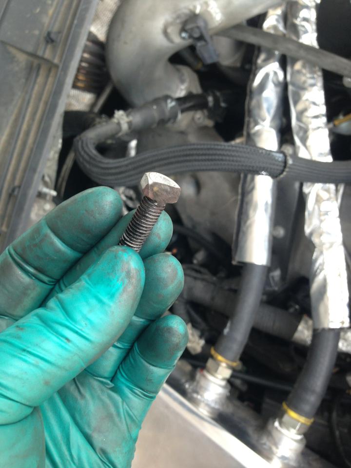

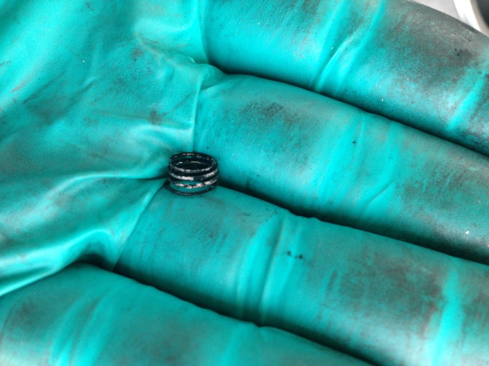

hahaha theres lots of little things "you notice that" things!!! ahahhaha and theres more to the story too... thats just the the turbo kit!!! other stuff that got screwed too haha
the the bolts that were used to bolt the headers down were only 30mm a (40mm bolt will fit in w/o bottoming) hence the 4-5 threads that were holding the headers down soon got pulled out, i think theres a pic of the pulled out threads somewhere in there! haah:joy:

Hopefully they gave you your stock stuff back. Those "headers" have always been the biggest hack job pile of **** to ever grace the market. You can see in that pic where the tubing they use is noticeably smaller than the head port. Rather than matching each runner piece, they just try to gap fill smaller junk with a mig. Performance loss nightmare
