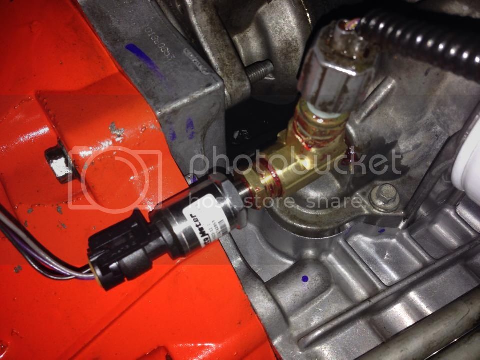

Also... I don't have the engine in front of me right now, where do you guys suggest tying into for oil pressure sensor?
I tied mine in right into the factory oil temperature sensor by the filter housing... Does that make sense?.. Here's a pic

is the factory sensor gone?
Isn't it a pressure switch? No it's still there just putting an aftermarket one in to monitor pressure
Wow!! Thanks kaleb!! Appreciate it man! That'll work perfect!!

Be warned.T'd into the temperature port will throw the oil temps way off. Put it on the opposite pressure side.
MorganY
Oct 3, 2011
2,950
college station, tx
Tying into the factory oil temp sending unit location for your additional pressure sensor will result in the factory temperature sensor reading out lower than being in its stock location.
Between the "T" used to tie into the system dissipating heat, and moving the factory temp sensor away from the direct flow of oil inside the filter housing, temps will read out lower. 20 degrees lower give or take a few degrees.

Ok yeah!!! Haha I follow that part!! I just don't follow what you are suggesting I do instead! Haha
Dan
Sep 4, 2013
909
Fort McMurray AB Canada
Yep 10-4 sorry I don't have the engine right in front of me or pictures too look at! But hey thanks for that!! That totally makes sense! Thanks morgan

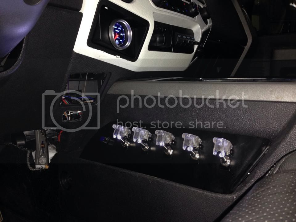

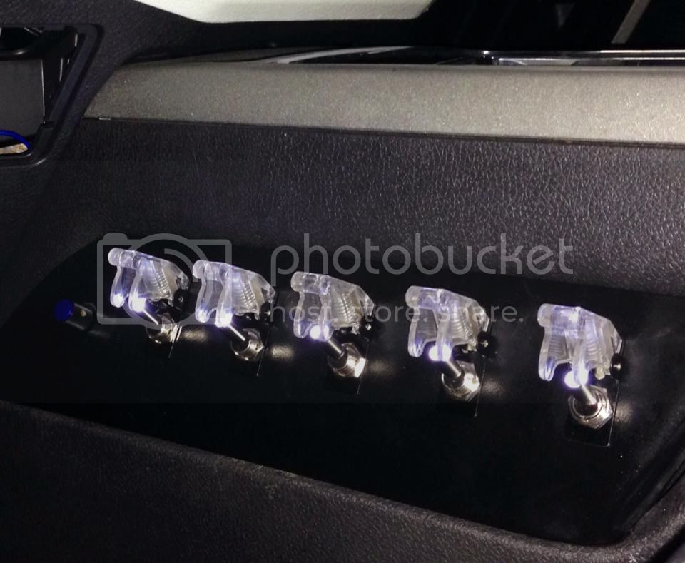

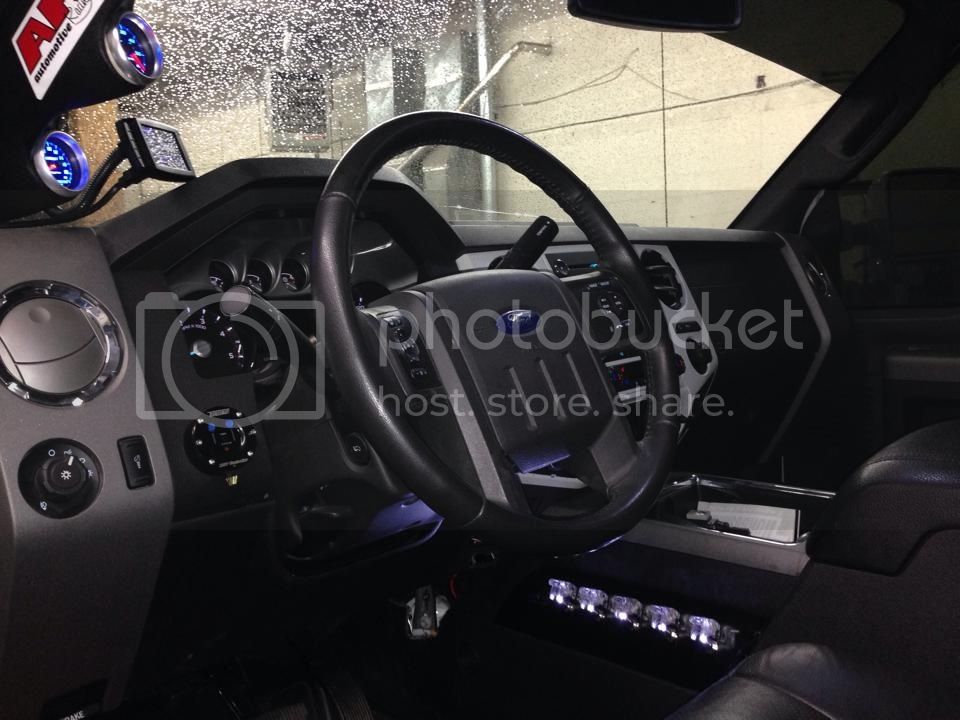

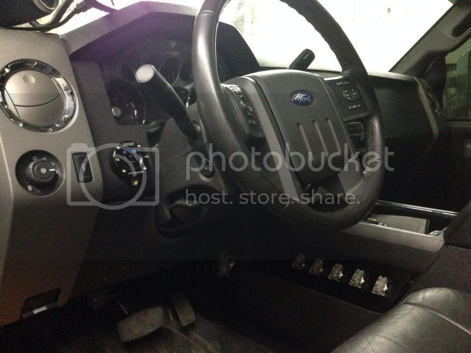

Your all good! I noticed that it'll leak a bit but you tighten it down real tight and then wipe up the excess oil once and it does good after that... I might be way out too lunch too! Haha
In other news: switches!
I swear this is the cleanest I've seen this truck! Haha
Kinda
And here's our variation of what kaleb so kindly shared!
Also there's a bov controller in there somewhere!

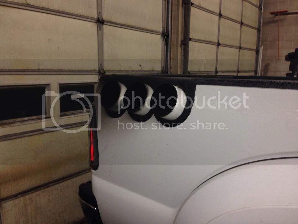

The switches are awesome. So awesome that I think I need a link to them. The exhaust coming out the side of the bed is awesome as well. First time I've seen this thread. Guess I'm gonna have to read back in here.
Crack85
Mar 2, 2012
2,616
Midland, Tx
The switches are definitely sweet. The truck will forever be dirty where the exhaust dumps through the bed.
