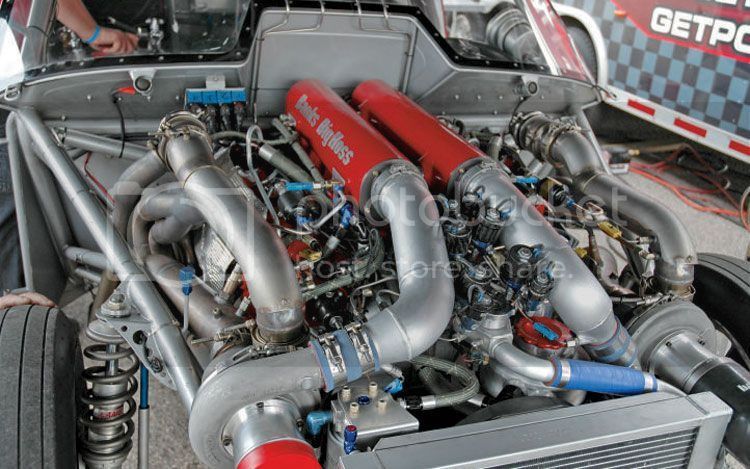

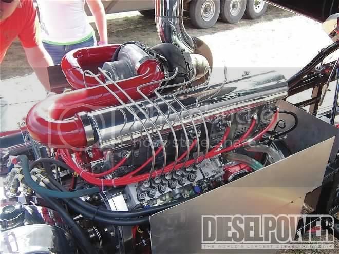

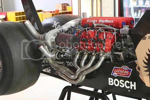

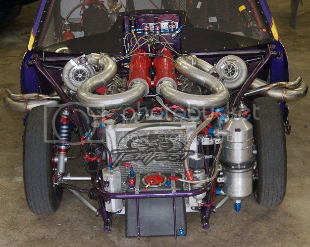

I'm sure some of you will recognize Wade Moody's truck:
Or the banks sidewinder:
I'm not the only one not using a cac to cool intake air temps...
Not sure what this proves though? These are all dedicated drag racing or pulling trucks. They can justify throwing gobs of water/meth or nitrous at the thing because it's only for a few seconds, and they are torn down every season or multiple times a season. You are talking about using your truck as a DD. Not the same whatsoever.
I commend you for leading the charge into new things with the 6.7, but I certainly think there is a smarter way to do it than just throwing sh!t at it haphazardly. In the end, it is your money and whatnot, but damn...

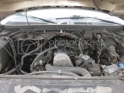

Started out as a 4.6L v6, (99 f150) but once that engine blew up, I wanted a diesel. Didn't have enough money saved up for a cummins quite yet. But I did have enough money for an 82 Mercedes 300SD. After I spent countless hours in my parents attached garage after school I ended up with a 99f150 with a om617.951 engine/ Mercedes 4spd auto. 2wd truck made driveline easy... Dropped tank, cleaned it out filled it with diesel, ripped the fuel filler neck flap out so a diesel nozzle would fit in there and of course put a stack in the box.
Did it work? Hardly. Highway gears in the Ford kept the Mercedes engine too low in its rpm range on the highway making it sluggish. 0-60 mph in 1min 20sec. Awesome mileage! 1000km/ 100L tank. But did anyone else have one? Nope. And did I learn a lot? Oh yeah!
