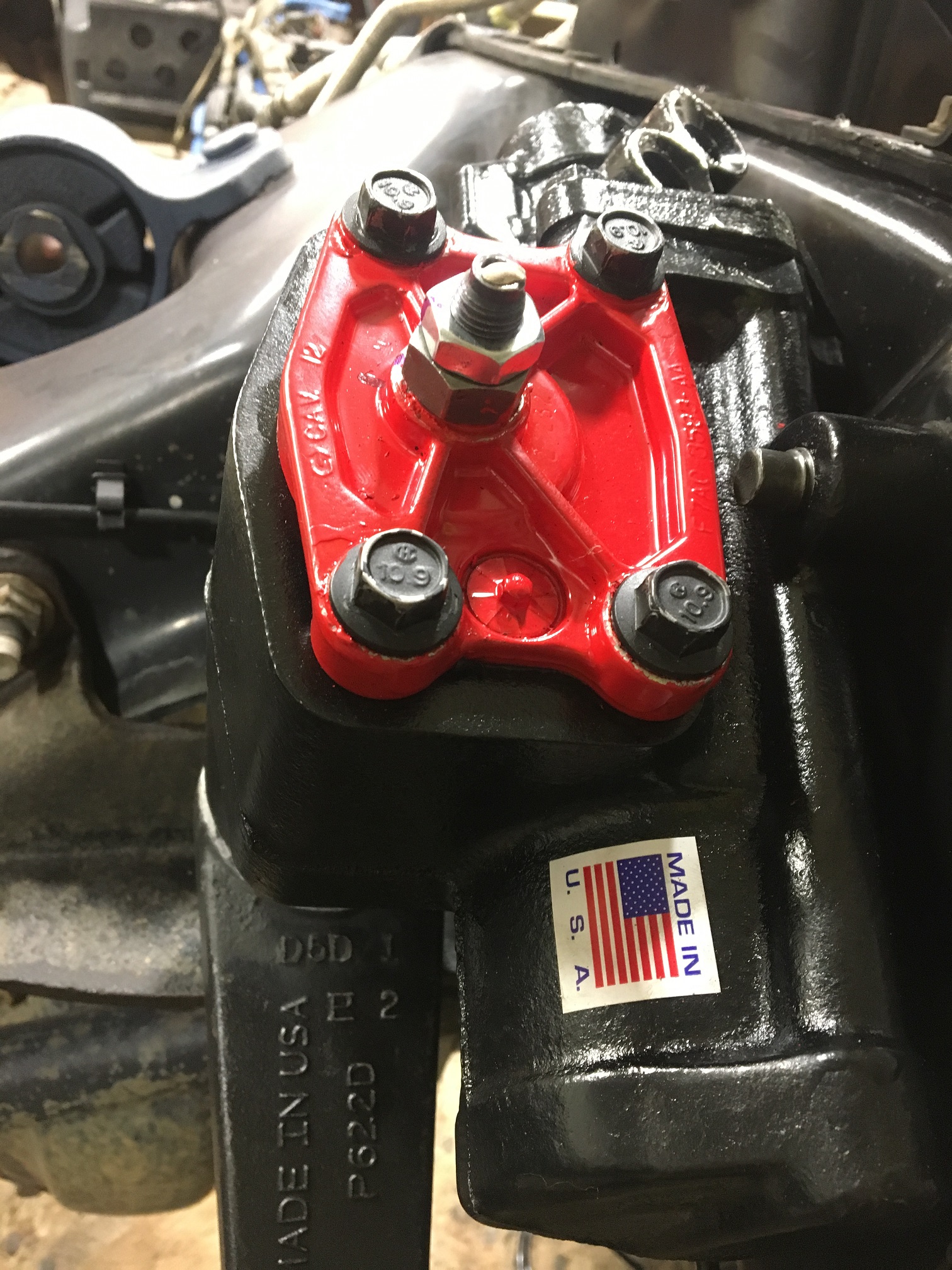

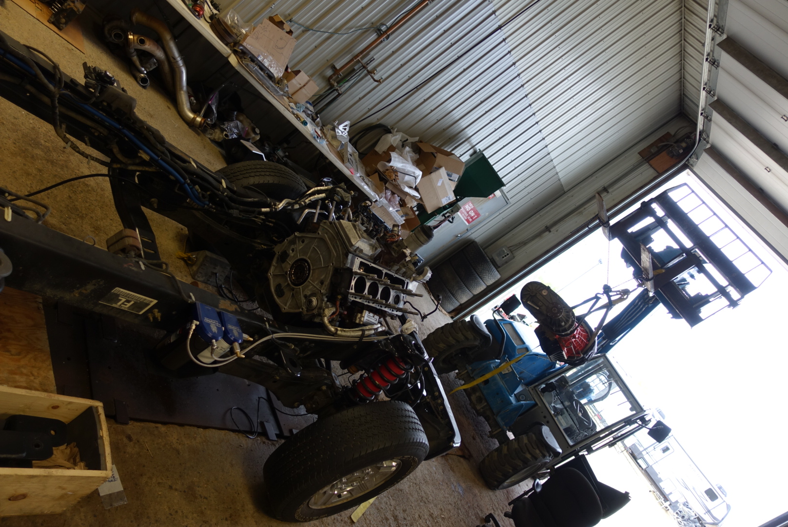

Fought getting the Pitman Arm off the Steering Pump. Little heat and now the Red Head Pump is in and that's about it.
Snowbike maintenance took over the shop for a bit :D:D

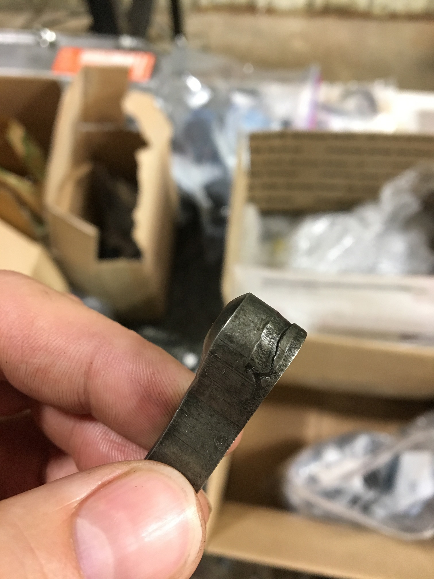

I have a concern about these plastic rocker arm clips on these reman parts.Found one had fallen out when I got them, tried to put it back in and the tab snapped off super easy. Any other options out there? Metal Clips?
Also my old valve bridges and the reman ones that I got have these grooves in the face of them. Are they all like that? Can you get brand new bridges anywhere?

I have the flow-pro 4" duals with MBRP tips is why I ask. I really like mine, but rarely see another with duals. I also have the redhead steering box and so far it's working great! I'm running 35x12.50x20's and the factory box struggled to turn them while sitting still. The redhead still struggles some, but is considerably better.
The rocker bridges are all like that from what I've seen. Shouldn't be an issue since there isn't much stress on that location of the bridge.
The clips, well, lots of them fall off. I haven't seen any other clips, but I re-used some of my originals that were the white plastic instead of the newer black plastic. They seem to be a little stronger and less brittle. The clip only holds the rocker in place until tension is on the valve train.

Good to hear about the steering box, I was on the fence about the swap but insurance is insurance, I know it'll be a improvement. My original rocker arms came with a beefier looking set of yellow clips....might examine and re-use. Sounds like they are a issue but not to big of a deal once there is tension applied. It needs to stop snowing up here so I can put the winter toys away and focus on the truck! Its been dumping at altitude across most of Alaska this week and all the freshies is really distracting :toast::cursing::joy:

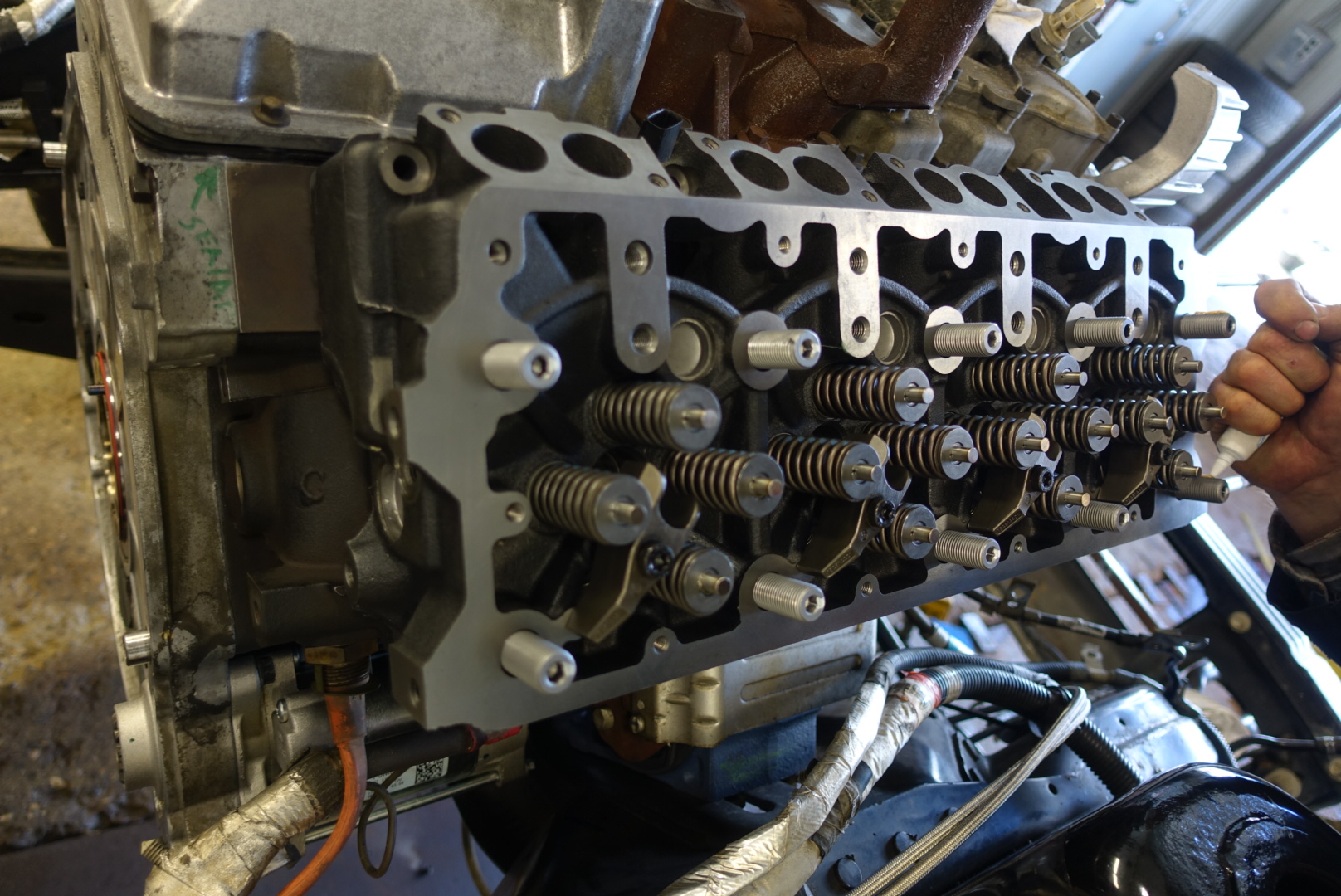

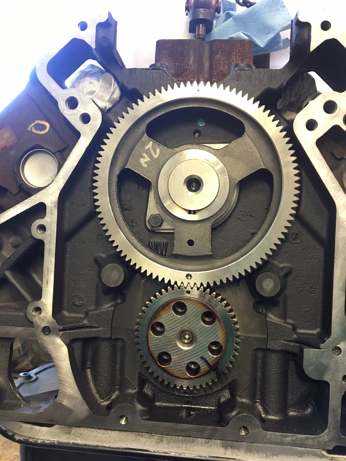

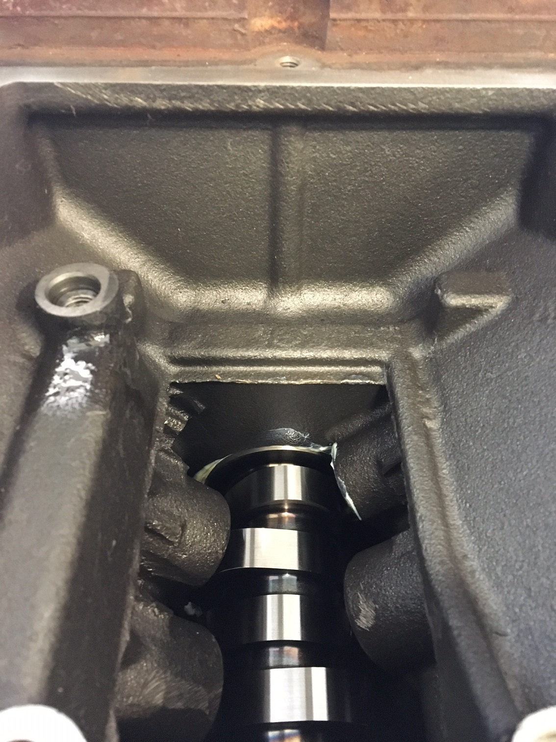

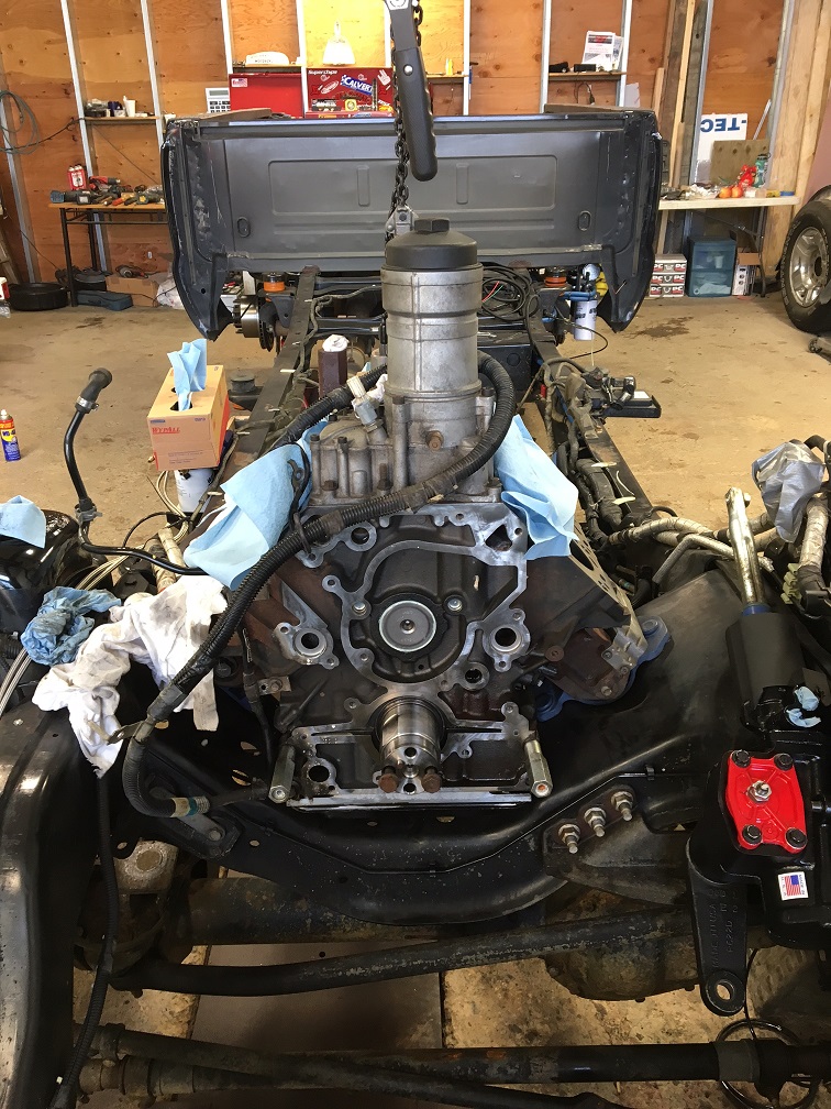

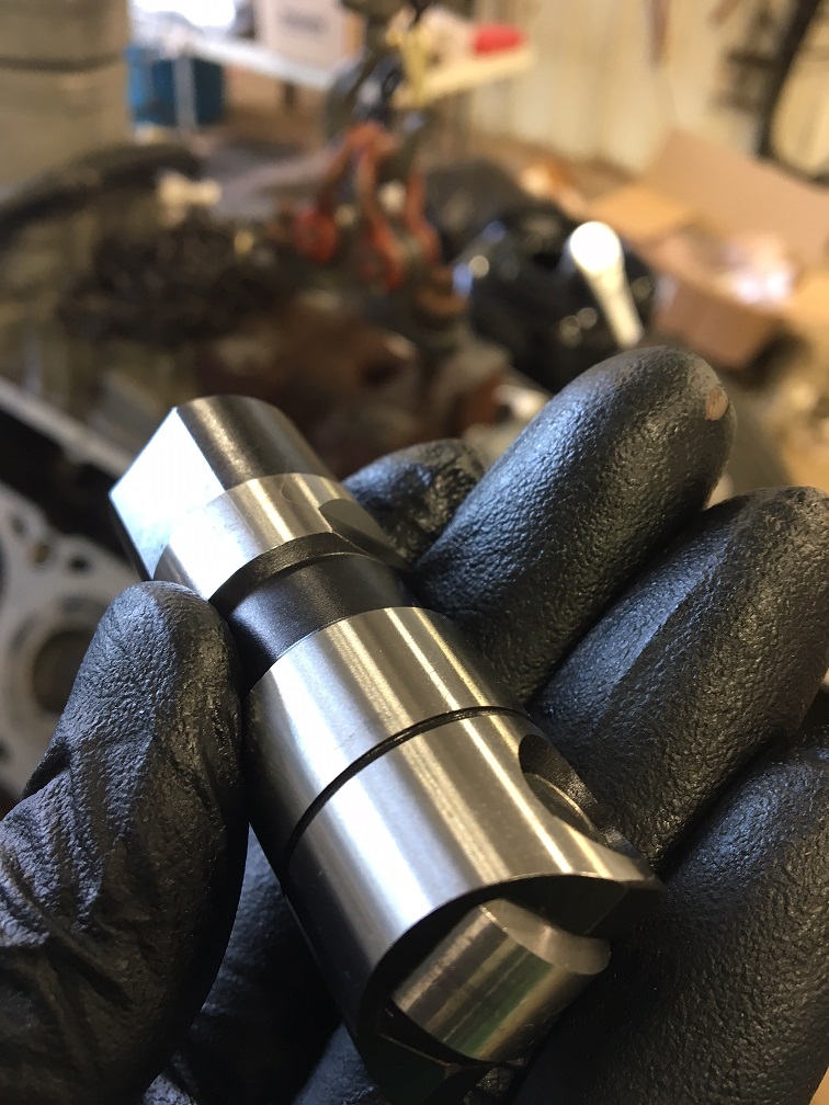

Got the cam & lifters in the motor and the motor back in the frame

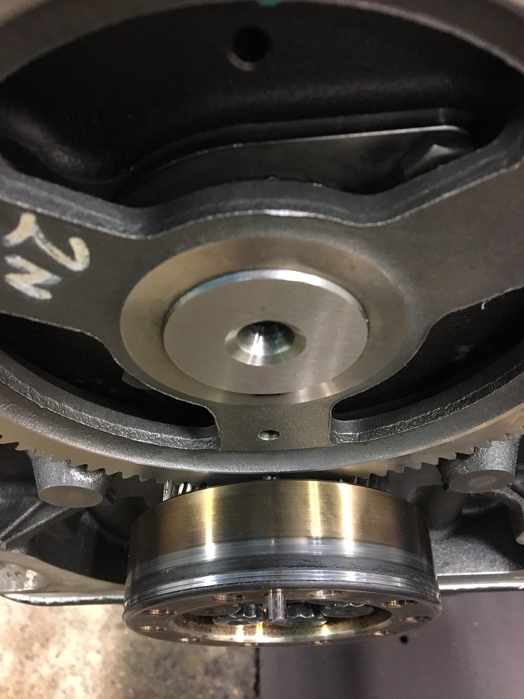

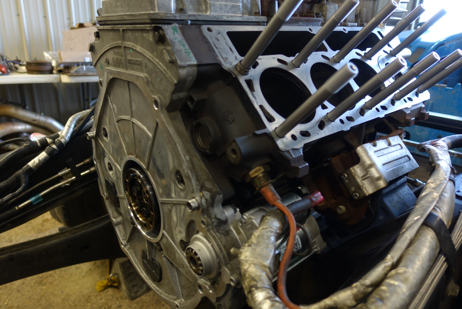

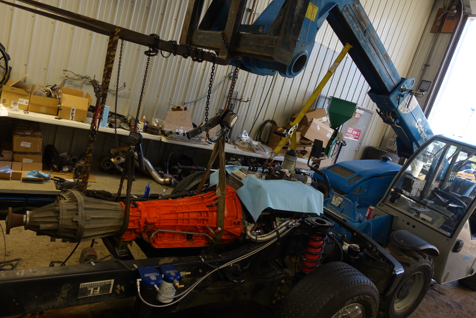

Update

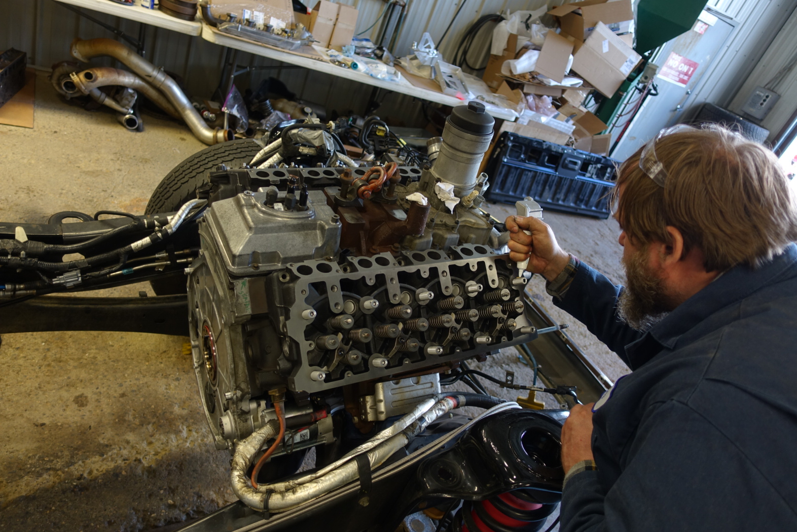

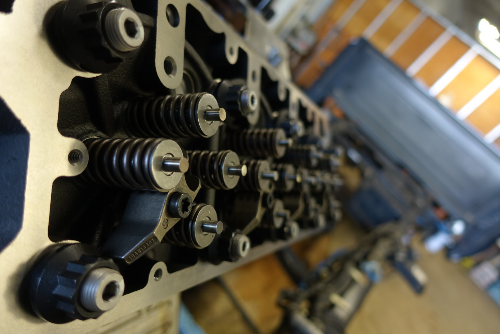

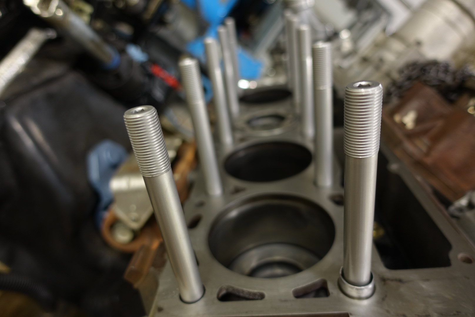

Front Cover on, Rear Cover on, New Starter In, Studs in, Headgasket On, Heads on, New Flywheel bolted on, and Transmission mostly in.
Made it to the last torque converter bolt and it dropped through the small gap and fell behind the flywheel :fustrate: finding friends with long flexible magnets before undoing and starting over...it always has to be on the last step where it goes wrong :lame:
Also broke the windy CCV tube that comes from the bottom of the crank...ordered a new one...probably a good idea to replace the brittle plastic anywho
Finally got all my cab insulators in after my dealer ordered the wrong ones on three separate occasions...small win!
Also, got my new wastegate dump pipe ordered from SDP...hopefully be here in time for up-pipe mock up
Slowely but surely parts are getting put on for the last time!

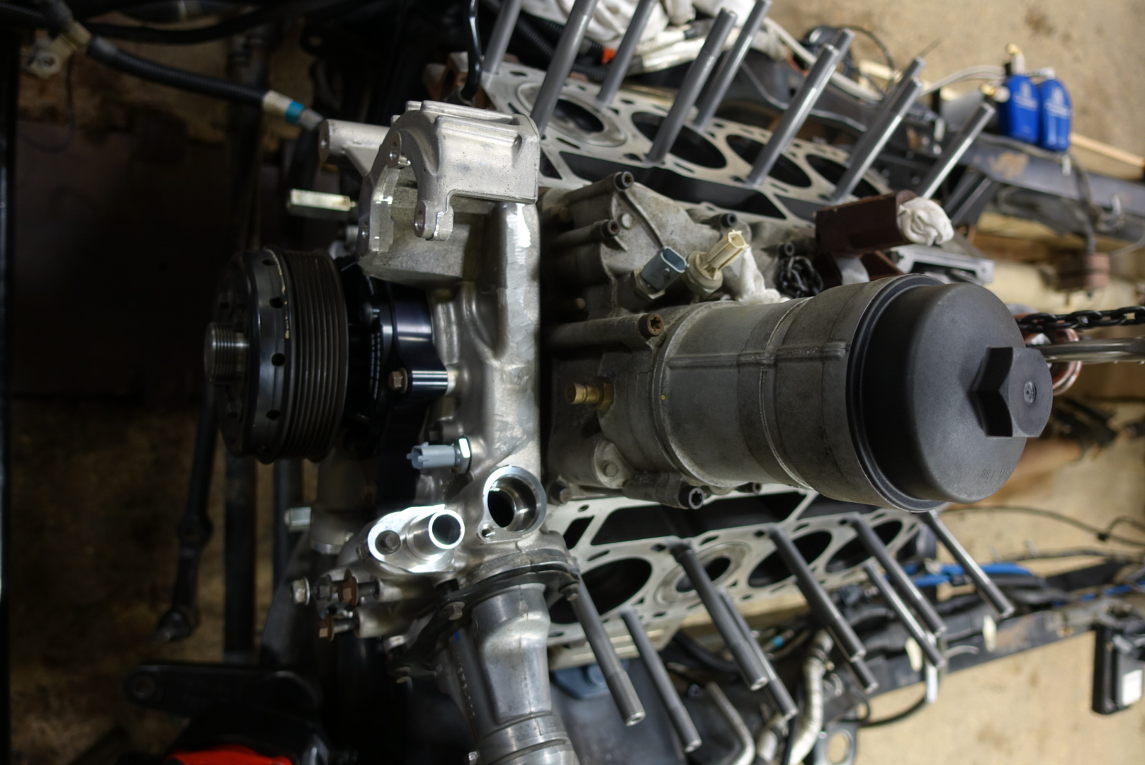

The light is at the end of the tunnel! Got the valvetrain in, fuel system all tightened up, tranny in and drivelines in, wiring is 80% clicked in with all new sensors, and got my new fox 2.0 shocks on.
Alternator, crank balancer, belts and pulleys on the front.
Turbos, Up-pipes, and wastegate plumbing on the back
Then its almost cab time!
Does anyone have a helpful list for start up? Whats the best way to crank the motor without ignition for priming? What are common things forgotten on startup? Is there any computer modules that need to be re-flashed before startup?

Use the jumper wire by pass side battery box to prime oil. Cycle key to prime fuel and fire it up. Smoky burnouts after 5 minutes of idle time.

with the cab up i always run 12v to the frame fuel pump and let it run for a while and periodically poke the schraeder valve to let the air out. :whs: about using the jumper to prime the oil once the cab is down.

Disconnect the Hpfp harness. You can crank all you want and it won't start. It will run the lpfp and pump oil through the engjne as well so everything is lubed before start up.
