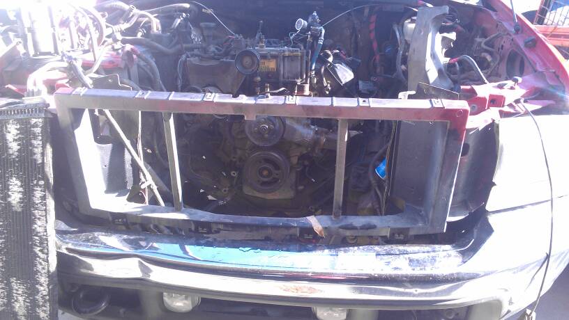

This is how it looked when the motor came out ,
..away from trans then straight up 8 inches. Then forward a foot or so, and straight up. Took 3 minutes from the time the bolts came out of the slots for motor mounts to when I was standing underneath looking at it. Not site why dudes have to pull the headlight panel, it was cake
sent while looking at a hole in my block
Because its soooo much easier to remove the header panel and the bumper. It takes 5-7 minutes more and you just walk it right out.

I agree with CSIPSD!!! Done this before and when you remove the whole front its way easier. Especially when it comes to getting it back in and getting everything in line and fitting together. Getting it out is always the easy part!
Well like I say, from when I hooked the chain to completely out was maybe 5 minutes, after a hour dicking with headlight clips I don't think I ever will pull it.

I don't remember headlights being a big deal... It's been a minute though.
