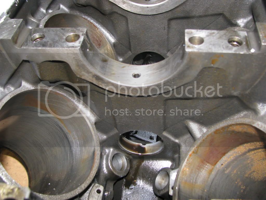

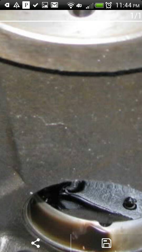

He is talking about the casting lines that lead into the cam journal.
