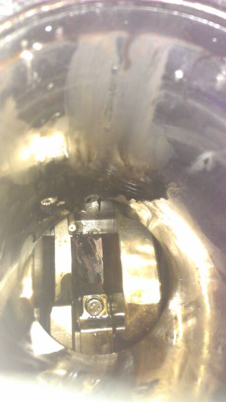

I also know of an 02 that "for sure has pmrs". Leaked oil real bad. Helped my buddy change the oilpan for the guy. We were doing the prep, loctiting the oil jets. I took a picture of the conn rods and.showed.them to.the owner. "I knew it had them crappy rods". I looked at him like he was an idiot that he is. Told my buddy, "that truck has.forged rods, what an idiot".

Thats interesting. I have never spent the time pulling the inspection cover and looking. My motor has seen enough and never bent a thing or broke anything when it hydro locked. Its a PMR motor to me because I would rather just build a full motor then gamble on a forged one lasting.

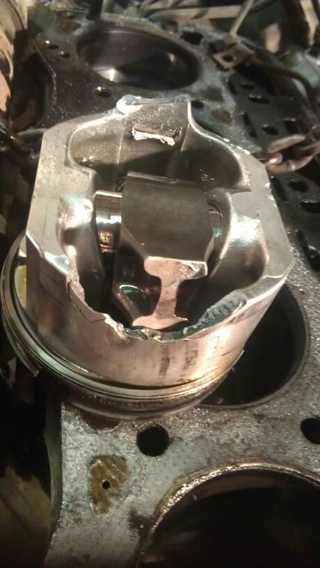

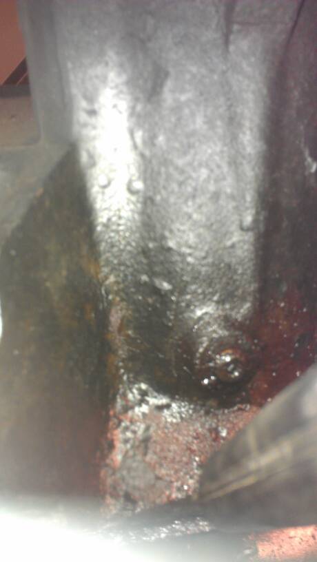

Started pulling the motor tonight, should have pics tom.

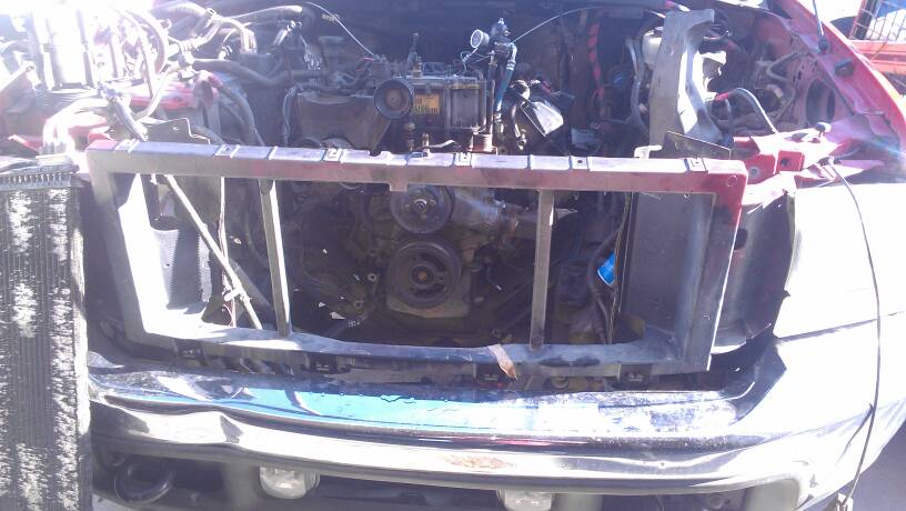

So if I pull radiator and IC and the first brace going across, will the motor come out if I put a come along on the front and tip it up ? Or does the headlight assembly and bumper HAVE to go
sent while looking at a hole in my block

I didn't take the bumper out, but realistically, it would have been easier to remover the bumper ahead of time. I had to work around it, jump in and out around it, blah blah blah.
But yeah, pull the radiator, ic, headlights, and header panel and the brace going across, and it'll slide right out. LOL

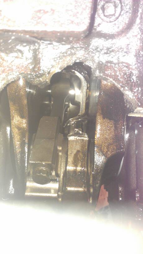

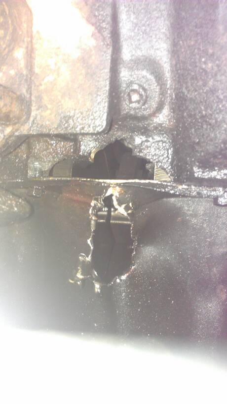

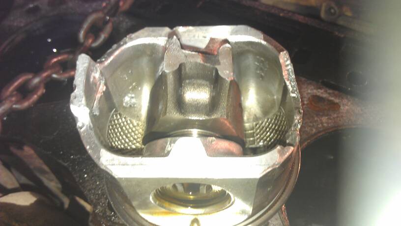

No worries. Keep it alive while I'm getting the motor out. ( staying tonight till its out ) pics are Comming soon I promise. Smacked the oil pan And heard lots of clatter :)

When I was prying down to get the pan off, the whole side of this block was " spider webbed " instead of the pan going down, the block moved out. Pics didn't turn out. , more today.

This is how it looked when the motor came out ,
..away from trans then straight up 8 inches. Then forward a foot or so, and straight up. Took 3 minutes from the time the bolts came out of the slots for motor mounts to when I was standing underneath looking at it. Not site why dudes have to pull the headlight panel, it was cake
