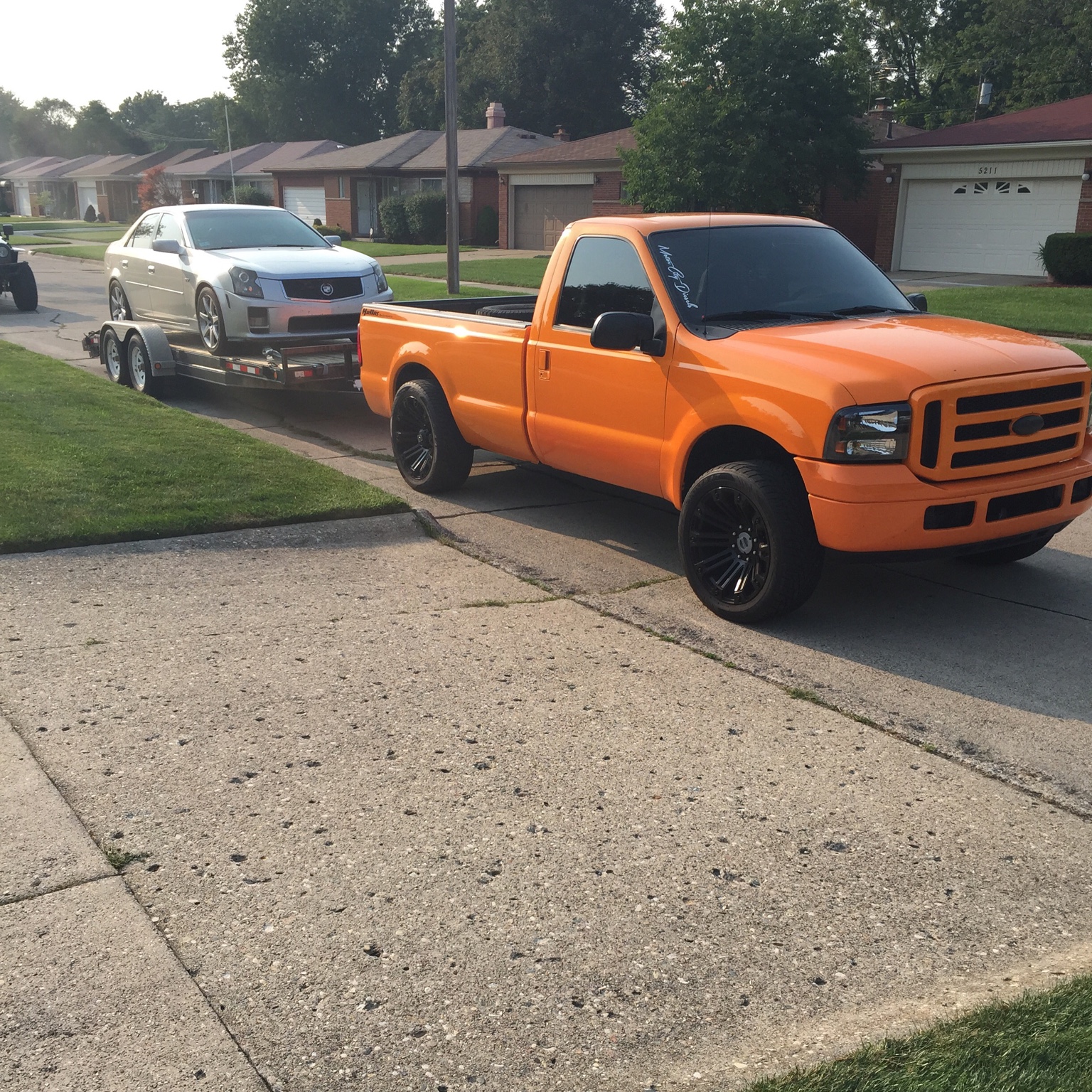

Towed this the other day. S366, 205/100's, and a GH tow file it wouldn't break 1200 at wot but had the power pulled back big time and she was still smokey around town. I have 4.30 gears too

It'll work, I was really surprised how much fuel GH was able to pull on the tow tune.. But it was necessary to keep the egt in check. You'll be stuck on tow/haul but it will work.
Unless you have 3.73's and 37's or something like that... That would be a nightmare
