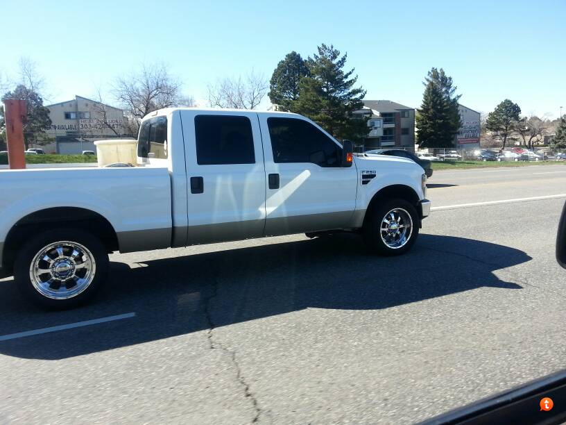

This is my brothers. No blocks and cut 5200 lb springs.
Sent from my SCH-I605 using Tapatalk
RSK
Dec 7, 2013
2,558
Connecticut
looks like it has a slight rake to it still? and is he rollin on 20's? i'm 22x10.5's with 305/45/22's but I see no reasons for anything to not fit still..
INFAMOUS
796
Denver Colorado
I think that's the camera. The truck actually sites pretty well perfectly level. Yes, 20x9 .

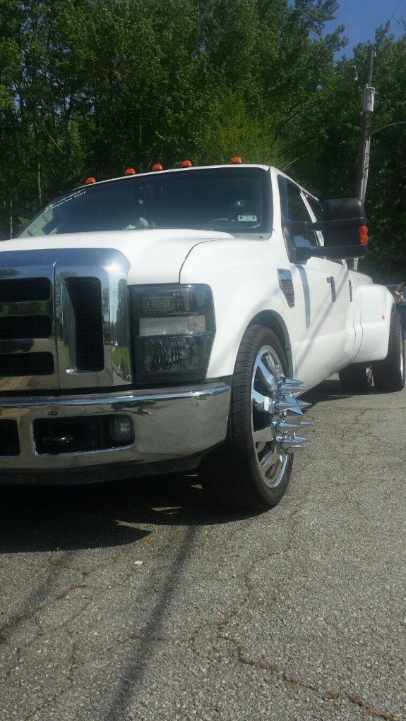

my trucks lowered with the 4400lb springs and no rear block as of today drove it around saying i was gonna get to pulling the blocks out and never did it, so I had a shop do it, for 50 dollars how could i go wrong. so they did it looks great, but I have a driveline shudder or vibration around 5-20mph roughly. I was looking to hit the track saturday morning for some test and tune action see what this turd does on these nitto 420's. but not sure I want to go with this vibration, did you have any issues after you pulled your rear block. oh btw my rear block was about 3.50" tall. so the truck has about a 1" rake which is perfect but now the vibration has got me all worried.
Jeff@Spartan
5,409
Georgia
I never had a vibration, but my truck was an F-250. My blocks were 1 7/8" compared to the 3 5/8" that your F-350 had. Your driveline changed a little more than mine did. My guess is you'll need a shorter single driveshaft or find a way to shim the 2 piece so that it will work, if that's even possible on a lowered truck.
