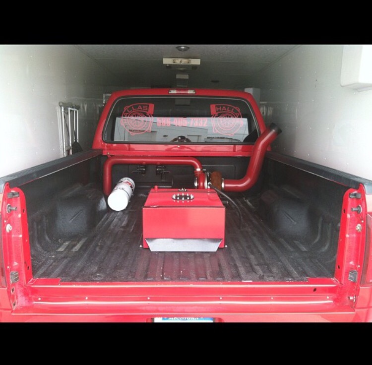

I am just curious as to why you are mounting the lp in the bed?
We want to see if it helps with BP and egt's, and to have room and less heat under the hood. I'm also strange I guess and want something different. Toolbox will be made to cover the turbo, and possibly a ice box but that's just a thought on the ice box. I'm sure some will call it stupid, and many other things lol but it's worth a try to see how it works out to me.

It works.. Mike Halas built a few bed mounted turbo setups, not because he thought that was the best way to do it, just because it was easy to mount a huge turbo without having to move anything under the hood... Sleeper factor too because his second bed mount setup he did the same thing and mounted the turbo in a toolbox.
That's awesome! I wasn't thinking I would be the first, but it will still be different. It is much easier, and sleeper is kinda what I was going for un till wot, pretty sure it will sound pretty good for a dd. I'm glad to know it was done and worked good, but my challenge will still be using vgt for hp

I had only seen the bed mount setup on gasser turbo builds. In our application it seems like it would introduce extra lag, but that's just my speculation.

Custom up pipes t4 mount kicked sideways with the exhuast facing forward, t6 s400 right on the exhaust outlet mounded sideways and a saws all for the hood done. With a big enough gate I really don't see how drive pressure will be much more than 1:1

Im very interested in the setup. I'd love to have a bed mounted 480 behind a 369. Or a 488 if all the extra piping doesnt increase lag too much.

Haller did a few bed mount turbo setups, everyone seemed to like them. I've seen a gas Chevy running around my area with a single bed mounted turbo. They ran it like that to avoid having to use an intercooler, seemed to work OK for them. Not really much different than one of those Squires Turbo rear mount systems they run on cars. No reason it shouldn't work. I like it.
