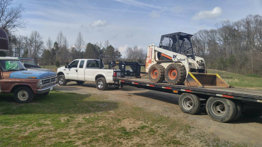

So we put it to a tow test. Pulled great, egt's never went past 1190. I'm going to get tunes tomorrow, gh said they could send me tunes. I know everyone has a preference on tunes. I'm not wanting a this truck to smoke much if possible, from others experiences who has better tunes? Right now truck defuels after 30 psi or so of boost, I'm just using stock sct tow tune right now.

^ no offense but truck looks weak with that setup. Probably tuning? Half throttle on my setup below would walk all over that. Throwing out some Competition I guess now lol your egts are cooler though than what mine would be by 100+ or so degrees

Edit^^ just read back and found your injector size (155). Yeah that's why I guess I stated weak. Work in progress for you build.
This isn't on big tune, and 190/75 injectors. I'm not pushing hard yet, I'll do a wot and big tune soon. Just playing safe so I can drive it a little first lol
