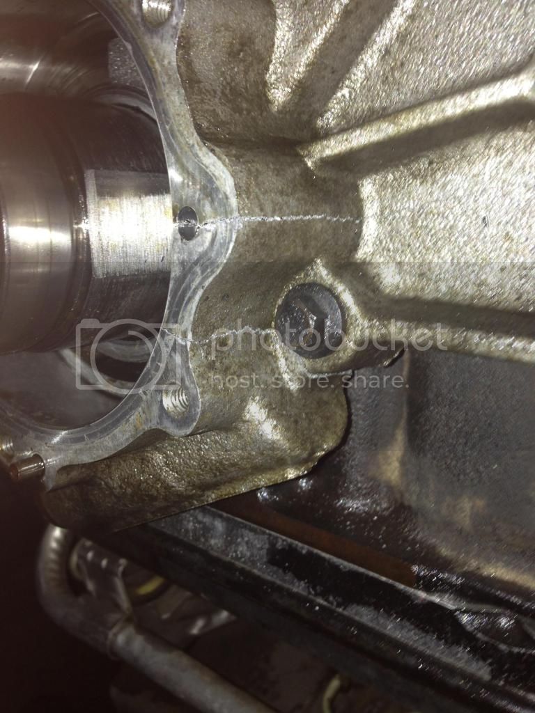

that would be awesomeWould it be possible to eliminate the LPOP and use a pump from a dry sump setup. Would that avoid this sort of carnage
Man, that really sucks!!! Hopefully a new LPOP and cover along with a good flush will get you back running. The truck has been doing so well too. I really wanna see 9's outta this truck.
Sent from my BNTV400 using Tapatalk
could you pm me with more info like price and pic?Yep we have done this several times on high oil demand 6.0's adds more lines and bs but makes for a more reliable setup with a ton of low pressure oil.
This is pretty common for the higher horsepower trucks running those dampners though isn't it? Well, maybe not common, but certainly not unheard of. And you guys are probably required to run an approved dampner no? I remember Ellerton complaining about them back in the day.
Yup is required for 9.99
I think I'm going to put the stock one on there and back up my 9.8 pass and try to better it some then try and figure somthing out with the damper later
Have you tried rebalancing the crank with the balancer? Or even tried a different ATI balancer?
