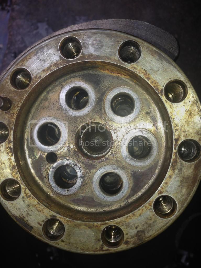

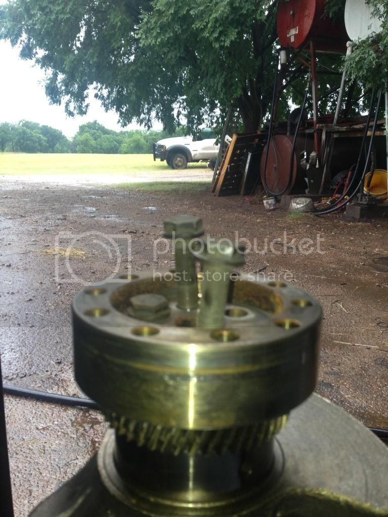

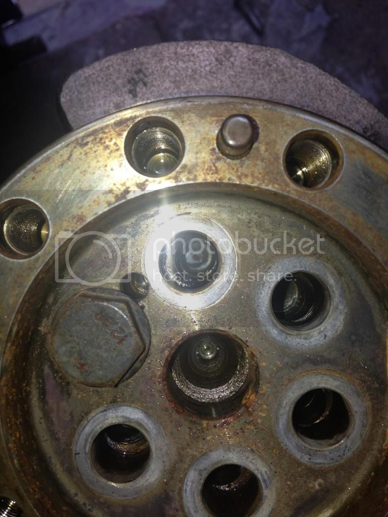

Found something interesting when I was pulling the crank adapter off the last motor that was I the truck. It somehow twisted it.

No there is no way it could have been put on like that. the threads would of been cross threaded like no other. it was bending the bolts when I was taking them out.

Ah makes sense, that is an impressive amount of force if those bolts were as tight as they are designed to be. Time for ARP to come out with a better option for bolts.
Chvyrkr
2,205
Could have been put on like that potentially? Seems like if that started to move with enough force to change the angle like you've shown it would shear those bolts right off with ease.
I've seen the TC bolts through a billet flex plate do the same thing, on a 600ish HP 5.9, using factory bolts.
We retapped all the threads in the TC and used grade 8 hardware when we put it all back together. Last time I heard, it was still going on the same TC and flex plate.
