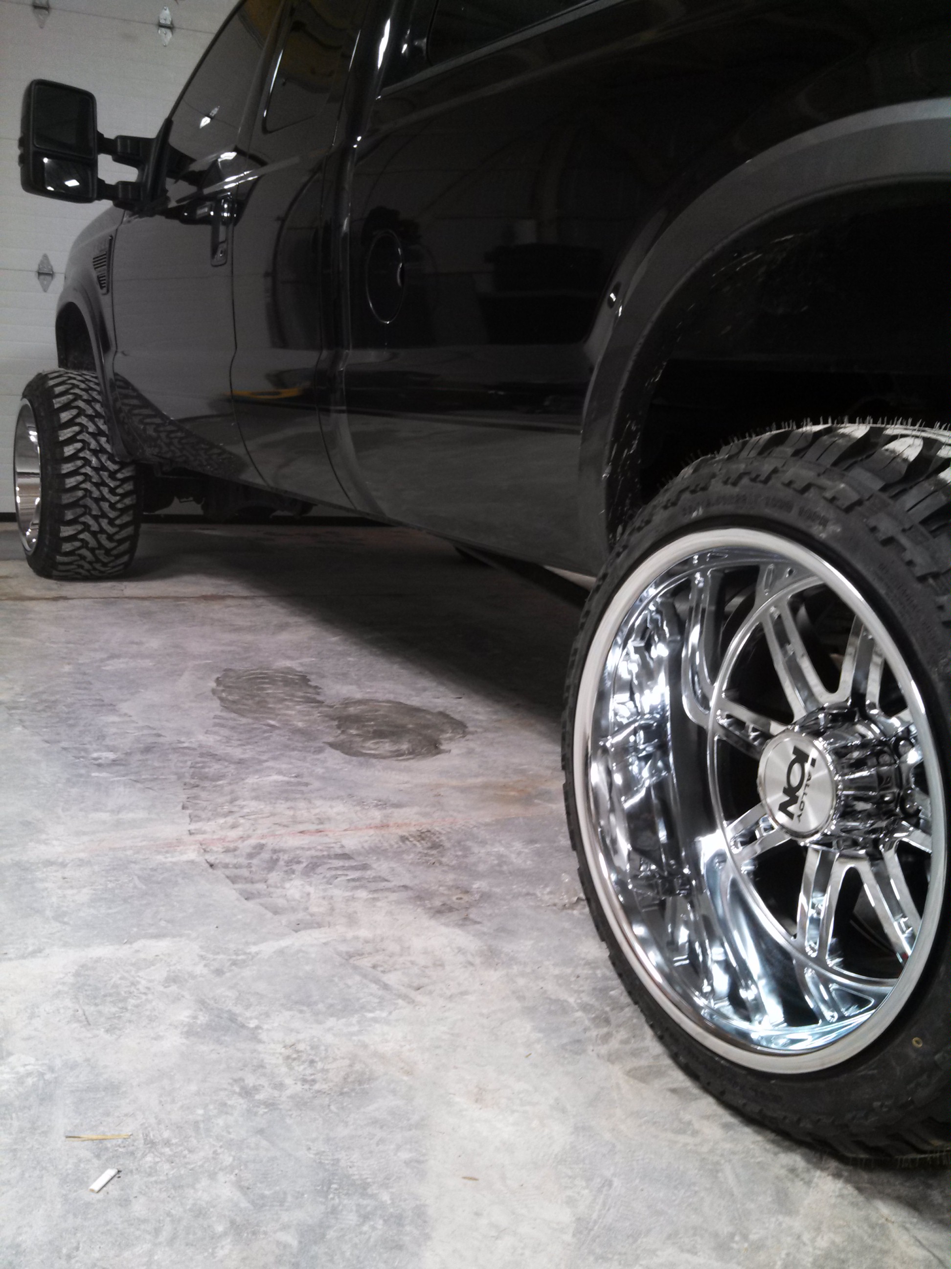

If these went on I'm sure a 12.5 will go on a 14 no prob. All those Cali and Florida bros do it all the time.
Ether and good air pressure is the key to success. The more ether and bigger fireball the better. LOL

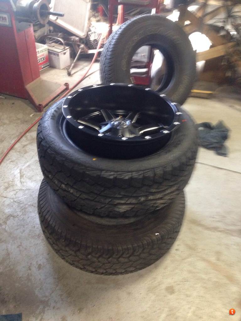

Ether and air actually didn't work for us. Two cheetahs and setting the tire right side up on a 5 gallon bucket. Push the bottom of the tire on as far as possible by hand. Two cheetahs at the same time and air and they went right on.

Try a ratchet strap next time. Strap it then add a lil ether and it will almost seat itself on the rim.
