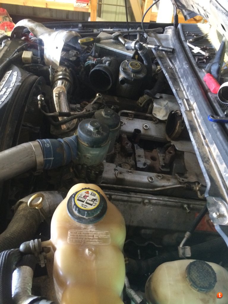

Damn you should of cleaned your engine bay before for started.

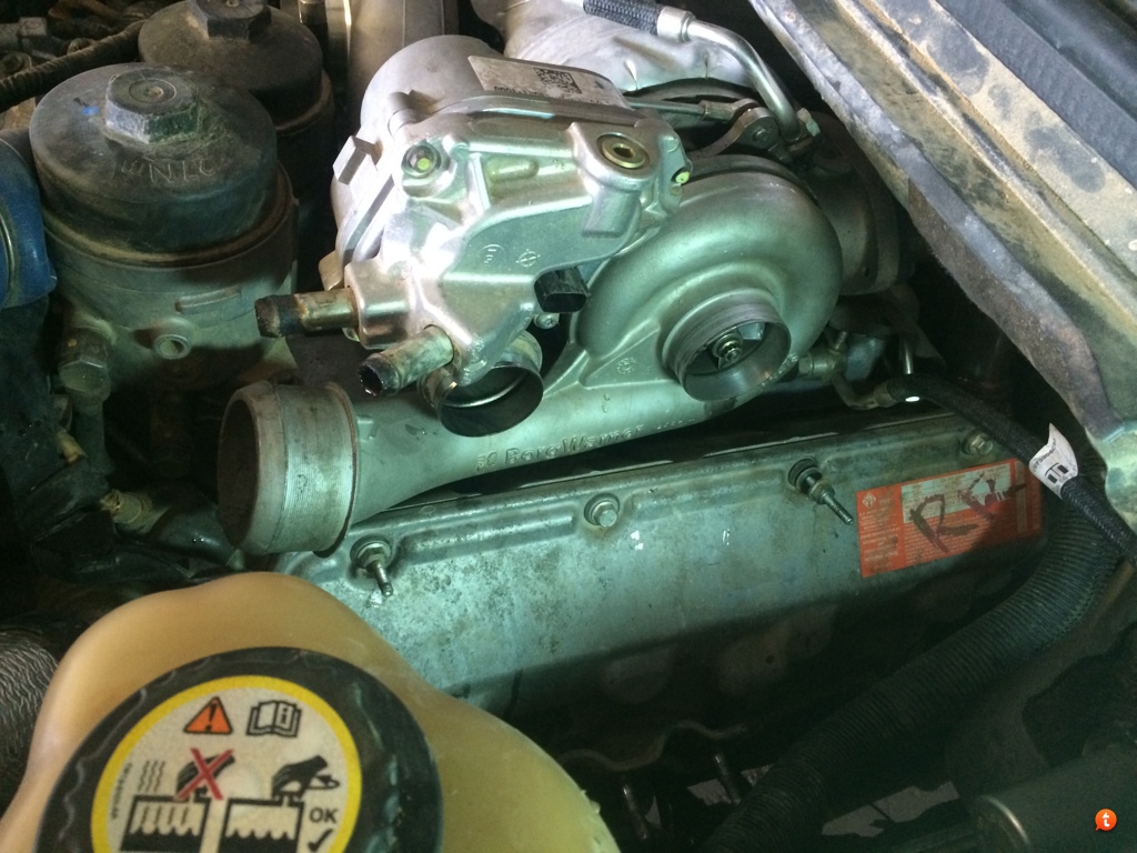

Take the v band off the Vgt and get the compressor housing out of there
Sounds great. Thanks. In the works on up pipes now. Then housing and oil feed lines
Ah yeah the Uppipe bolts are a pain only cause they're tight and you can't get much leverage on them
Press in pin holding VGT actuator to HP turbo. How do I get this off
The pin is pressed in...u are going to need press to get it out without damaging it.
Yeah. Sucks. Cause I don't have anything but a c-clamp.
Might try o reilys and borrow one...if u get both turbos out you can use a 2 arm jaw puller and press it apart.
