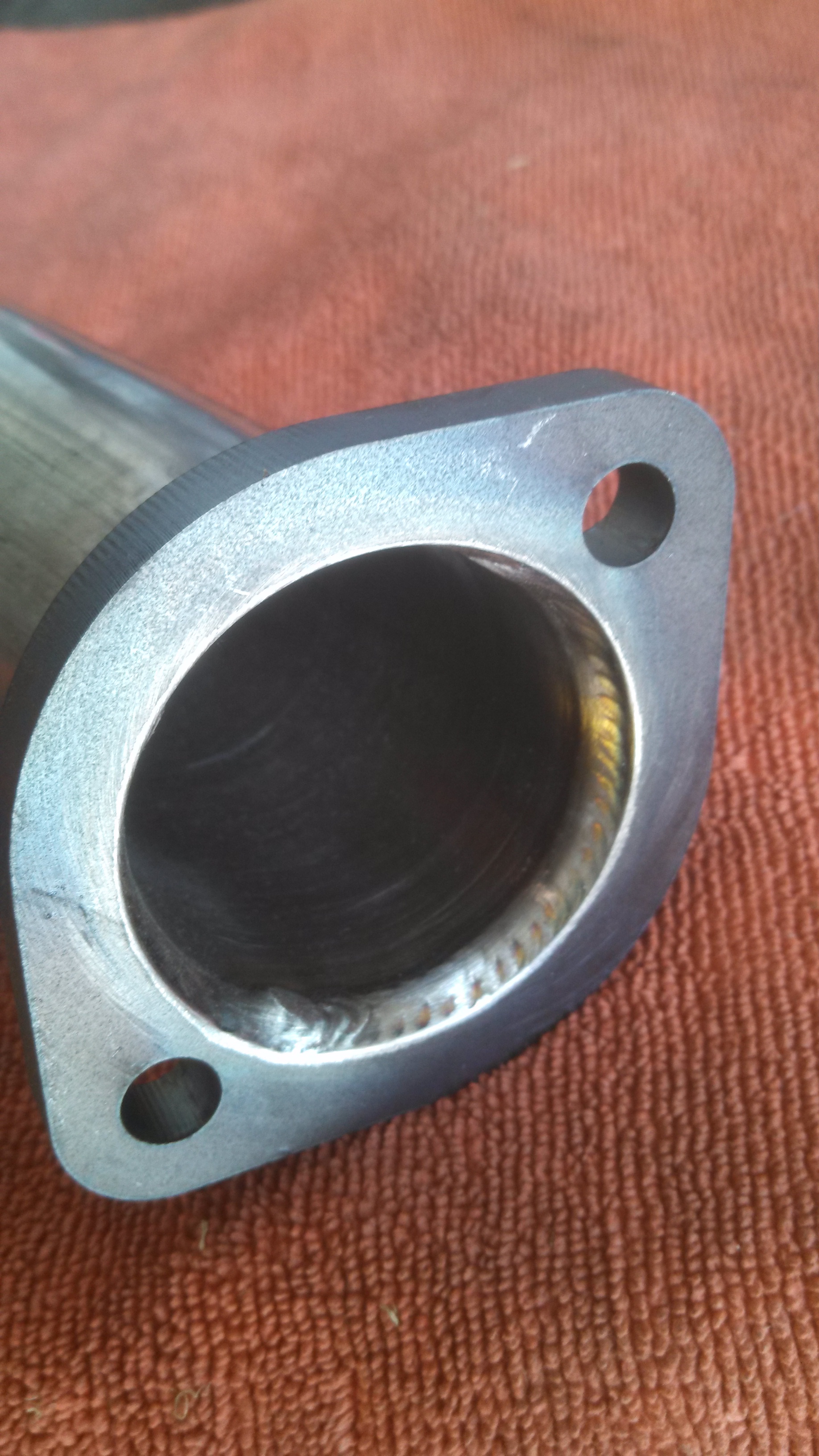

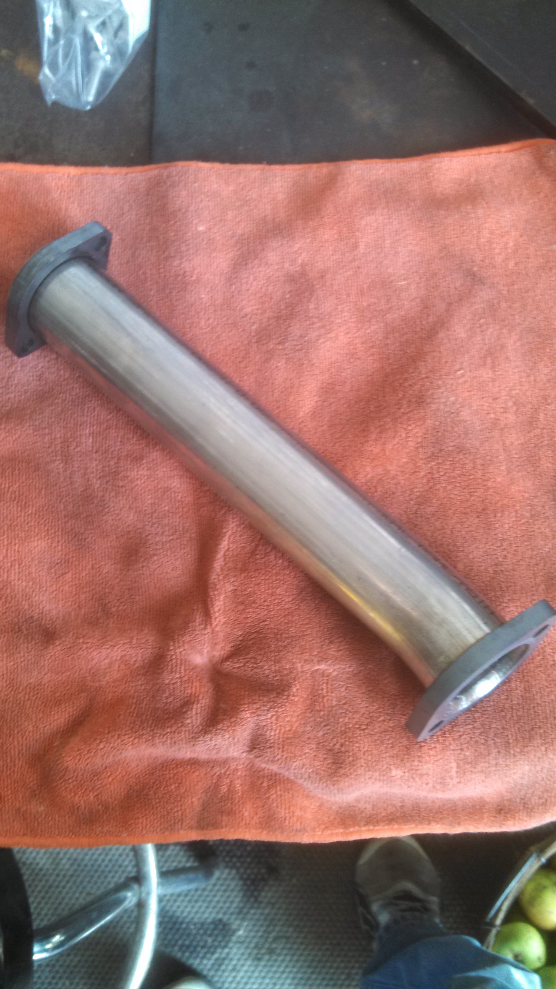

Truck has been running good. Adjusting the water injection a little. Took out the 225 nozzle and switched it for a 375. So running one 375 and one 625 nozzles. Started to get some parts together for this next spring. Ordered a set of MPD's up pipes and RCD's egr delete pipe. Here's RCD's delete pipe. Awesome quality and the welds are top notch.
