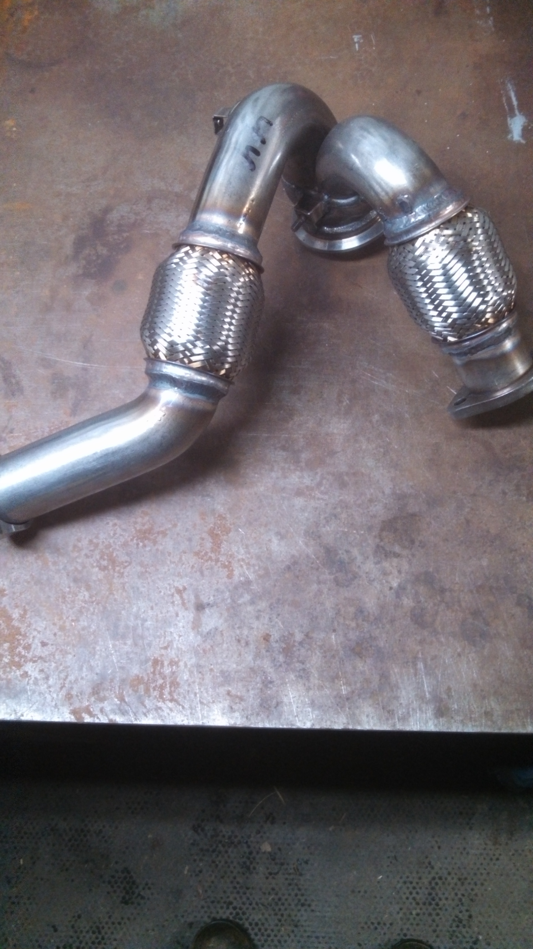

MPD up pipes showed up today.

Does the MPD up pipes have a stock collector at the turbo or is any sort of machining done to smooth airflow? Just wondering does it flow better than stock?
strokin6L
2,979
Springville NY
The MPD pipes are just a new set of stock up pipes that MPD uses to install the HD bellows/ flex joints. The collector is untouched. I might try to do something with that tho idk yet.

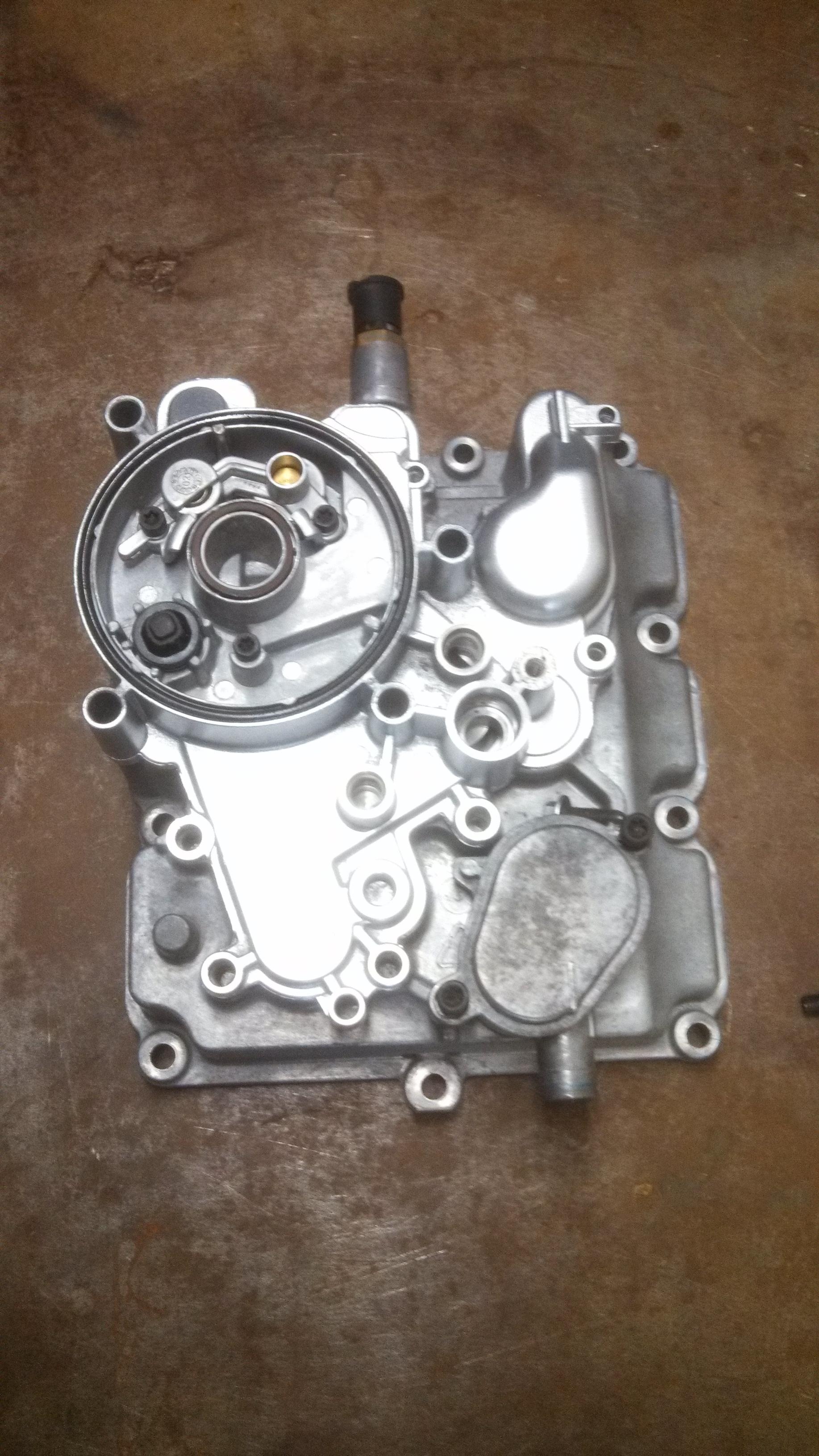

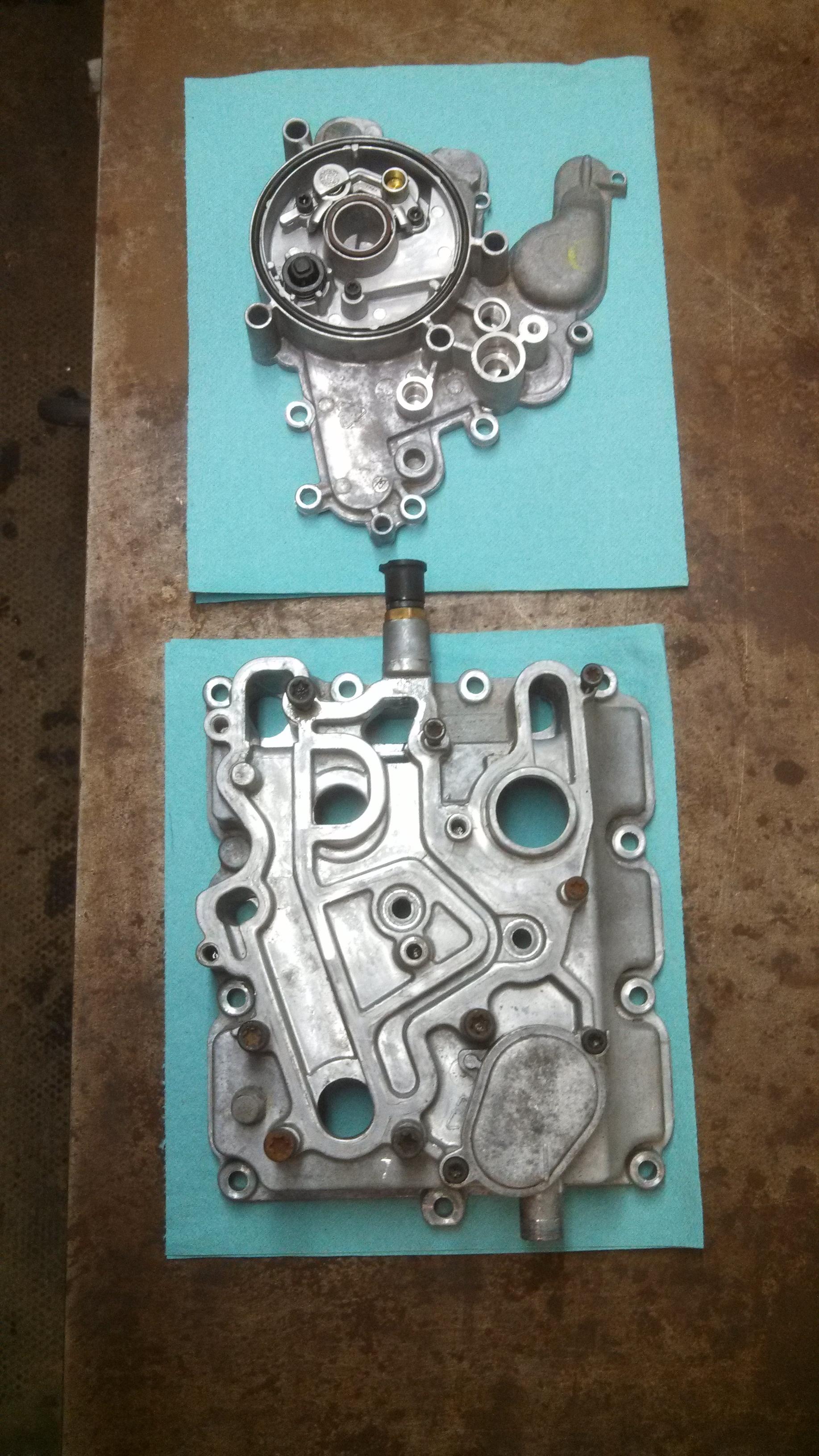

Gonna be replacing the oil cooler in the spring. Figured might as well while the intake manifold is off. Took the oil cooler cover assemblies off of my spare engine and cleaned them up. I thought about painting them....what do you guys think...natural look or painted? Thought about painting the bottom assembly IH red and the top one bright silver.

Every bolt will also be replaced with shiny stainless ones. Its little stuff like this that I like doing to make it stand out.
