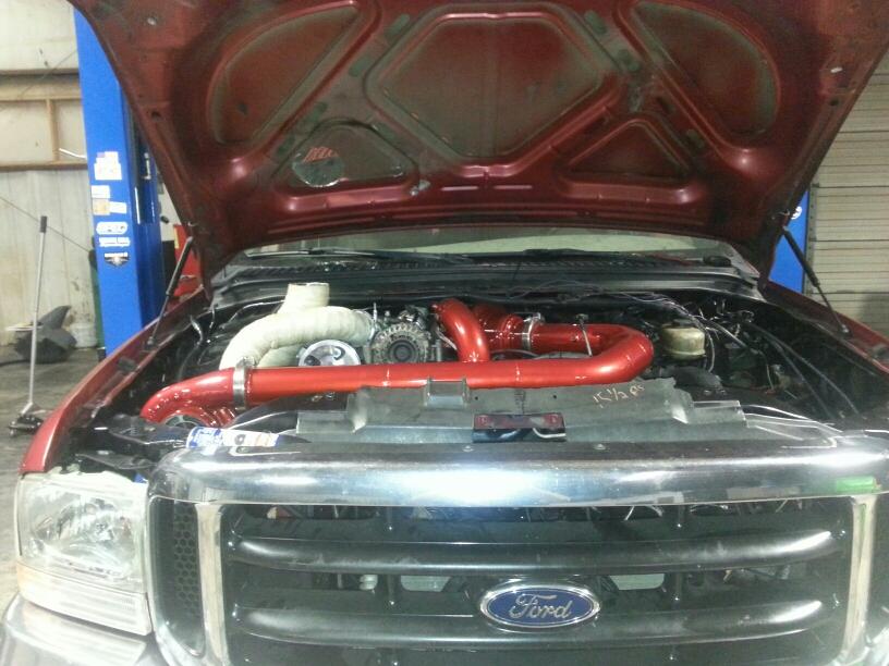

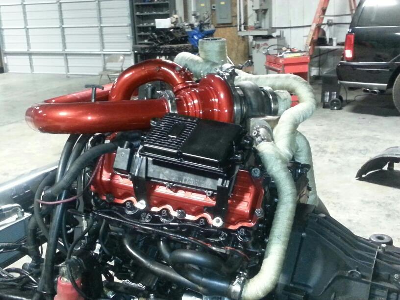

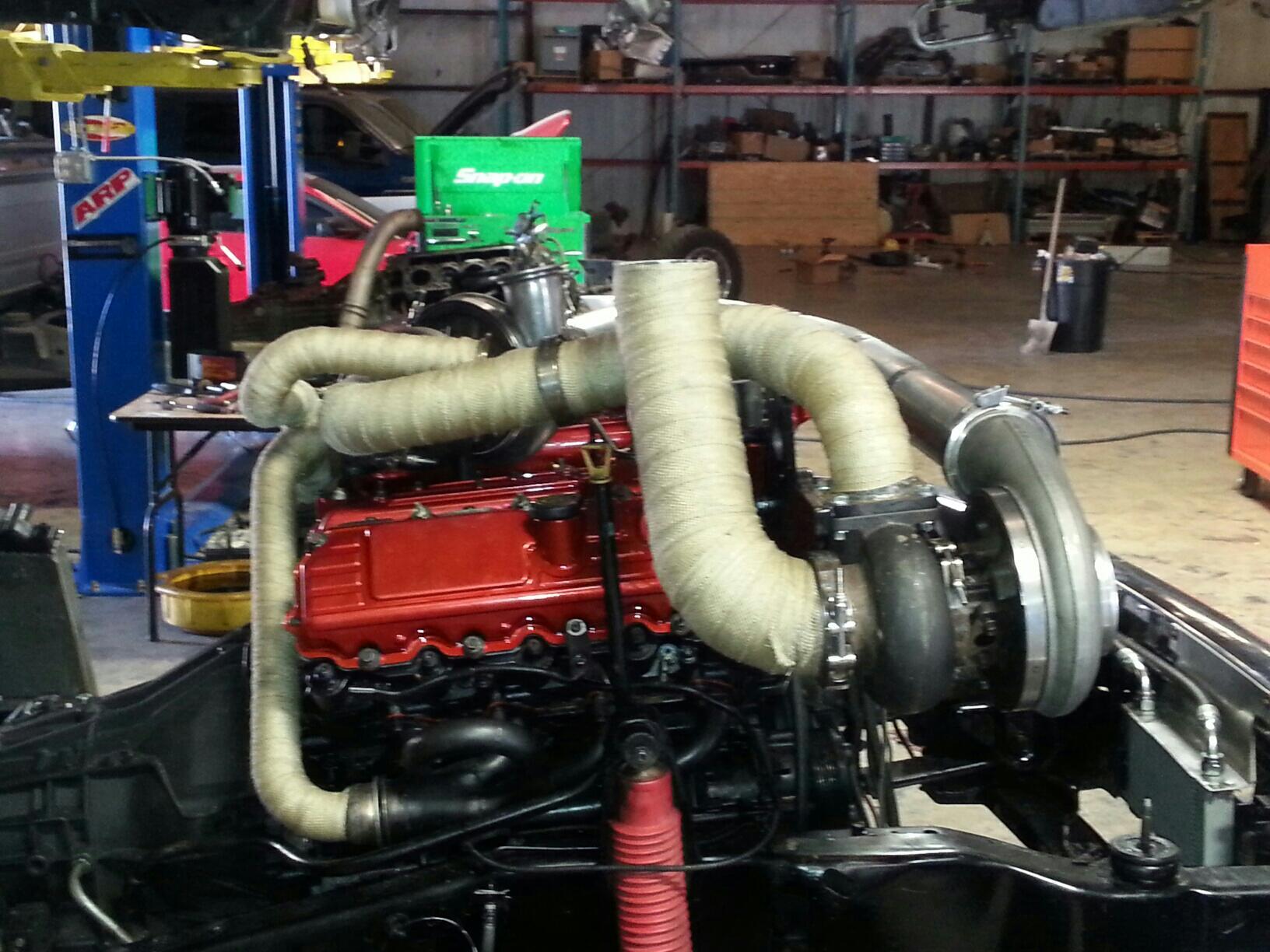

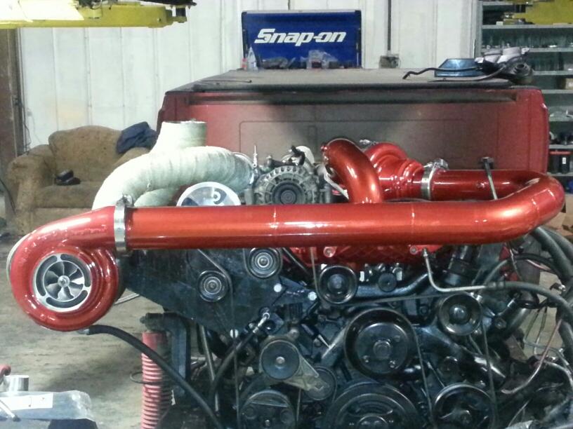

Compound Setup S480 and S472
Warren Diesel 500/225s
Dual High Pressure Oil Pump Kit
Fuel Lab Fuel System
Headers and Up Pipes
O Ring Heads
Cut and Coated Pistons
Hypermax Rods
Sun Coast Transmission with a 2800 Stall Converter
Water Meth
3 Stage Nitrous System
The truck put down 705whp on Fuel on a Mustang Dyno and on a .093 Jet put down 810whp with just one stage. More numbers to come... with more tuning.
