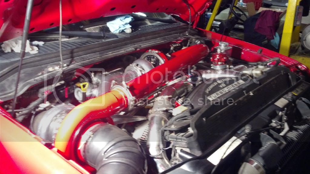

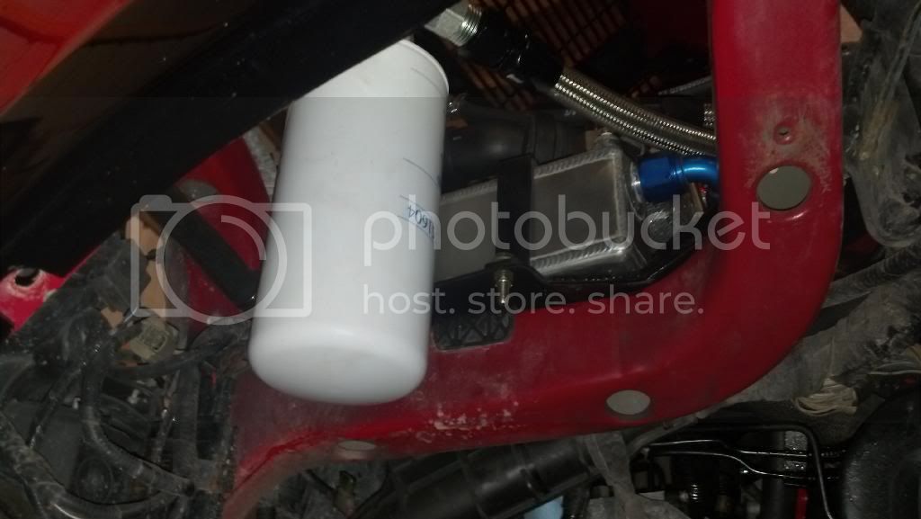

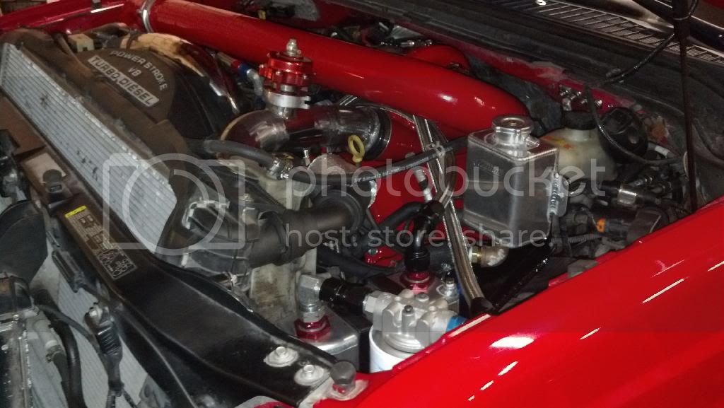

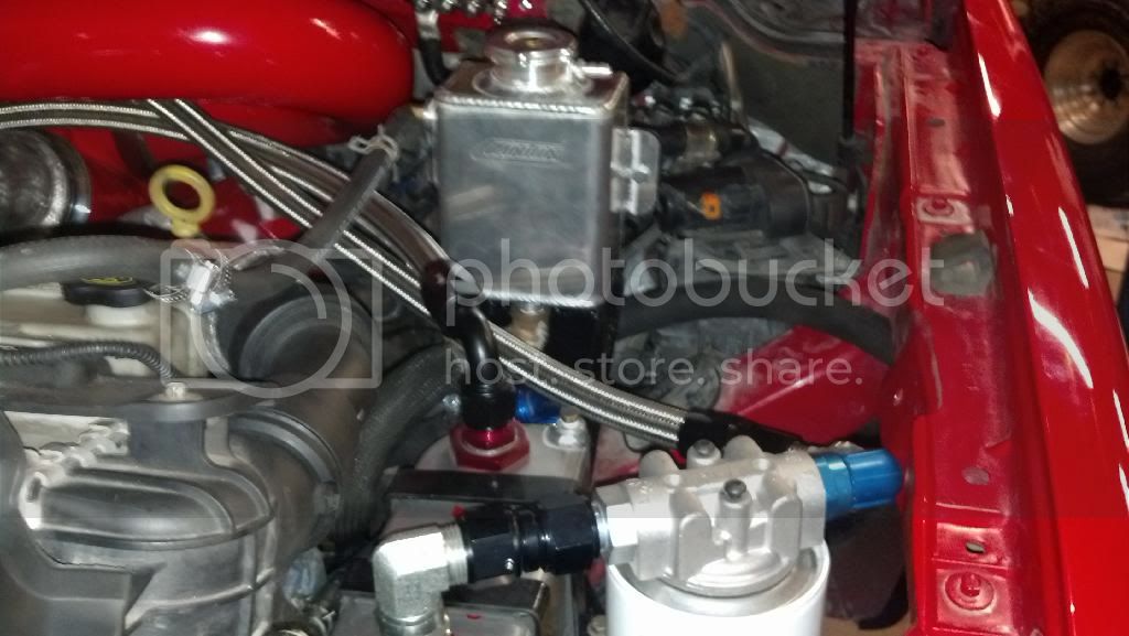

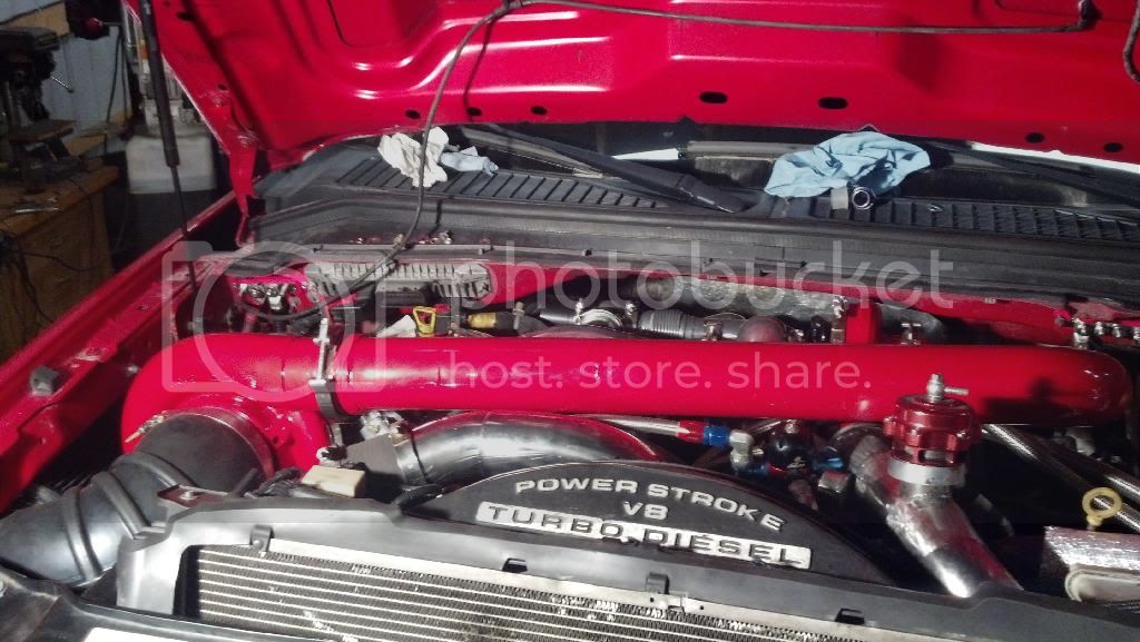

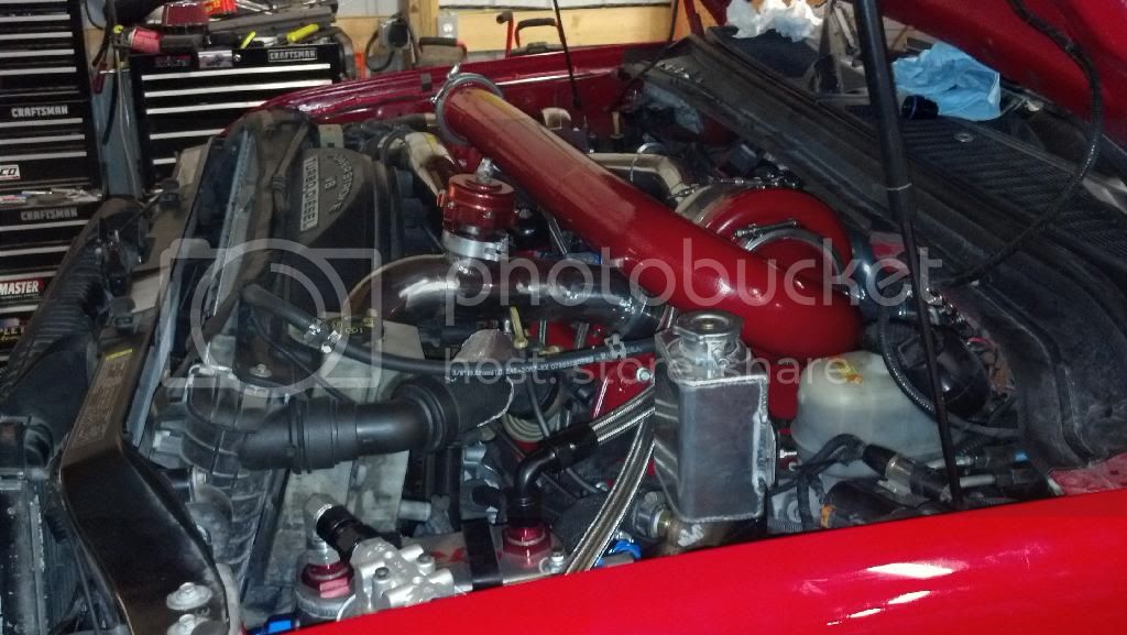

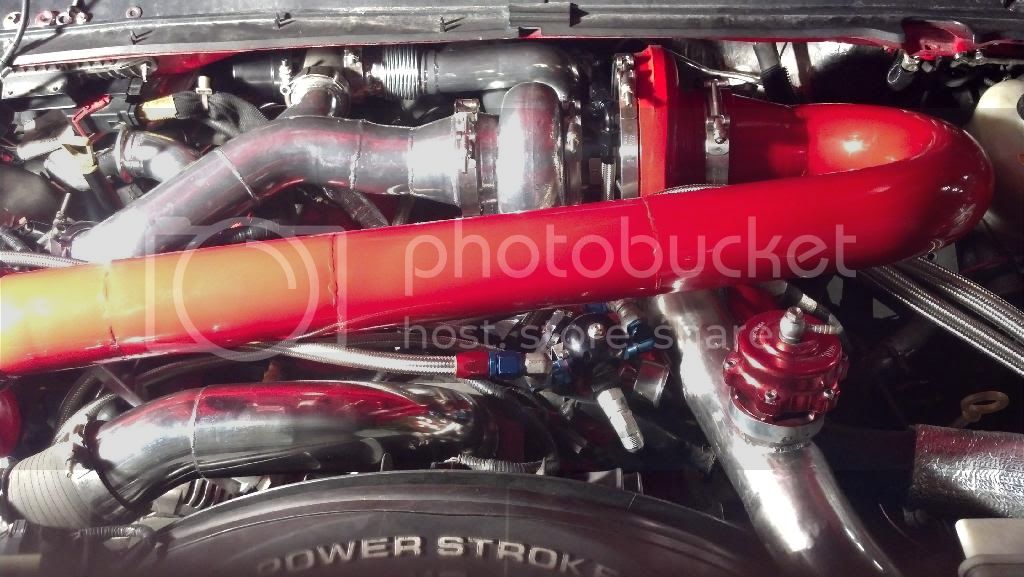

Tonights progress:
B585Ford
Mar 17, 2012
2,730
WV
....that is the most beautiful sight I have ever laid eyes on....and I saw your hoggin pics already.
