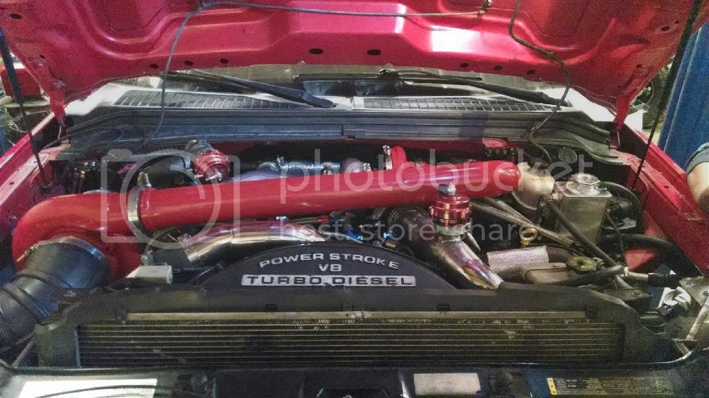

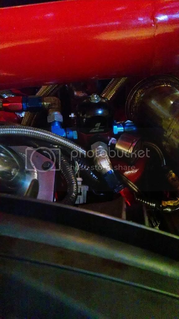

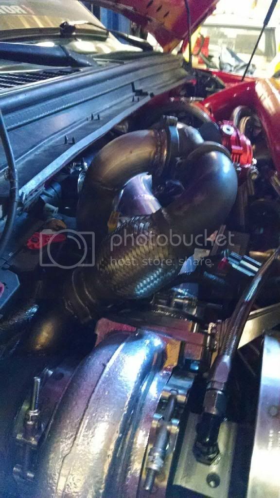

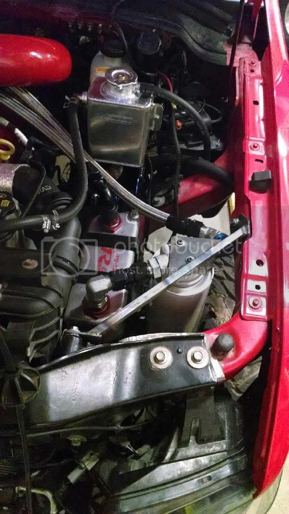

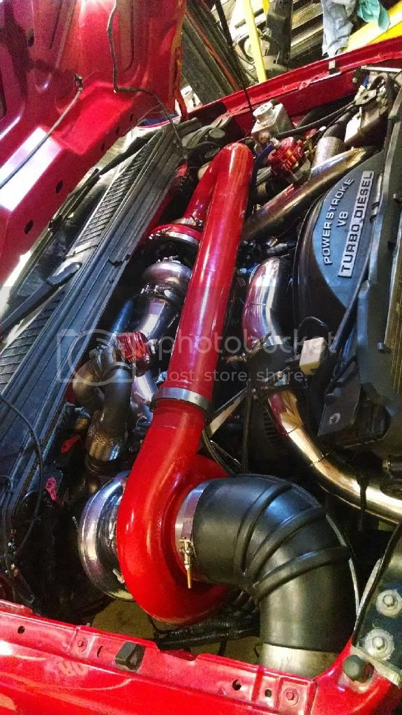

It may sound like **** but at least it looks good I guess
