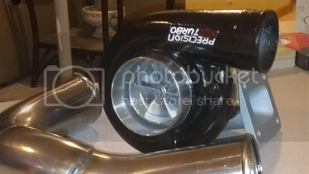

What do you guys think about the colored in logo on my High Power Atmo Charger? Just thought the all black was a little plain.
