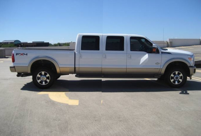

The cab stretch is still making me nervous.
A quick and dirty photochop. This truck has no lift and 18 inch wheels.
The cab length behind the front seats is 75". Length wise its like adding a 70 inch sleeper to a Superduty regular cab. Its not as tall or as wide as a 70 inch HDT sleeper, but it will be a pretty comfy space none the less.
