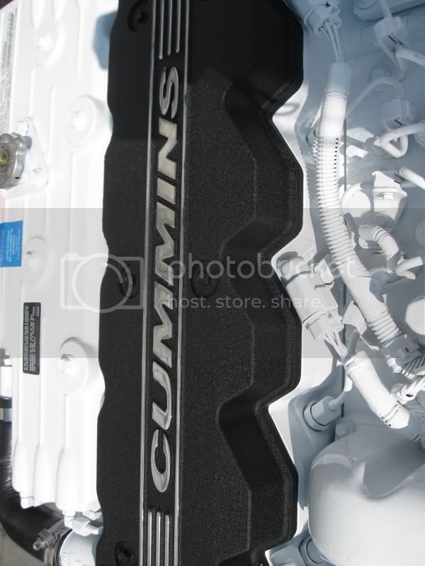

I had to un order my 24V valve cover. They are held on by several bolts down the center. My engine needs 6 bolts in 2 rows.
I ordered a Cummins marine aluminum cover. Part #3969481. $175. Ouch, but its blingy.
The original part number on that cover is #3969484, but it is unorderable and its just the cover. 3969481 is the complete assembly, including bolts and some breather apparatus.

It looks like this.
The oil filler hole is in the front. Some other covers have them in the back, where it would be under the cowl.
Did I mention its blingy ? It comes unpainted. Some people polish them, others paint them. The one in the picture looks powder coated.

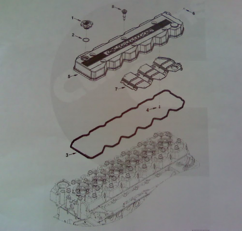

The rocker box (the piece under the valve cover) is different. The 6.7 valve cover gasket will not work with that.
me2
Nov 14, 2011
548
They look the same in the Cummins parts book. Tell me more.

You are right, its different.
The 6.7 box is straight on the injector side. This one has cut ins.
So it looks like we build a cover plate for the top of our 6.7 valve covers and chop down the filler pipe.

You could remove the 6.7 rocker box and bolt that to the 6.7 head directly with a 5.9 gasket and harness if there are enough pins, but would there be clearance for the rockers and injectors? You'd have to cut a hole in the new valve cover also because the 6.7 head has no pass through for the 5.9 harness.
